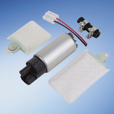

@nzenigma  I'm curious about the burnt wiring at bottom of fuse box and the high current draw. Would have been nice if that value was recorded. The Fuel pump has a 15Amp fuse I would have thought would blow on overcurrent.
Not sure how hard it would be but if pump motor was defective, there are kits available from Bosch at about 10% of that OEM unit. at least with a compltete unit it has new filter and sender unit.
:link: Genuine BOSCH Main Inline Fuel Pump 0986580979 universal EFP007 | eBay
311111G500 is the OEM pump motor
Filter Unit
31910-2H000

Actually, you can hear the pump prime while still in the drivers seat.
The scanner charge ...wow must be paying off a beauty. :rolleyes:
Was the pump even replaced?  :rolleyes:
 Or just added $680 to the bill.
Which ever way it goes, the pumps are as reliable as; and  even if it was faulty, no way one drawing a high current at the back of the car, is going to ONLY cook a terminal at the front.
