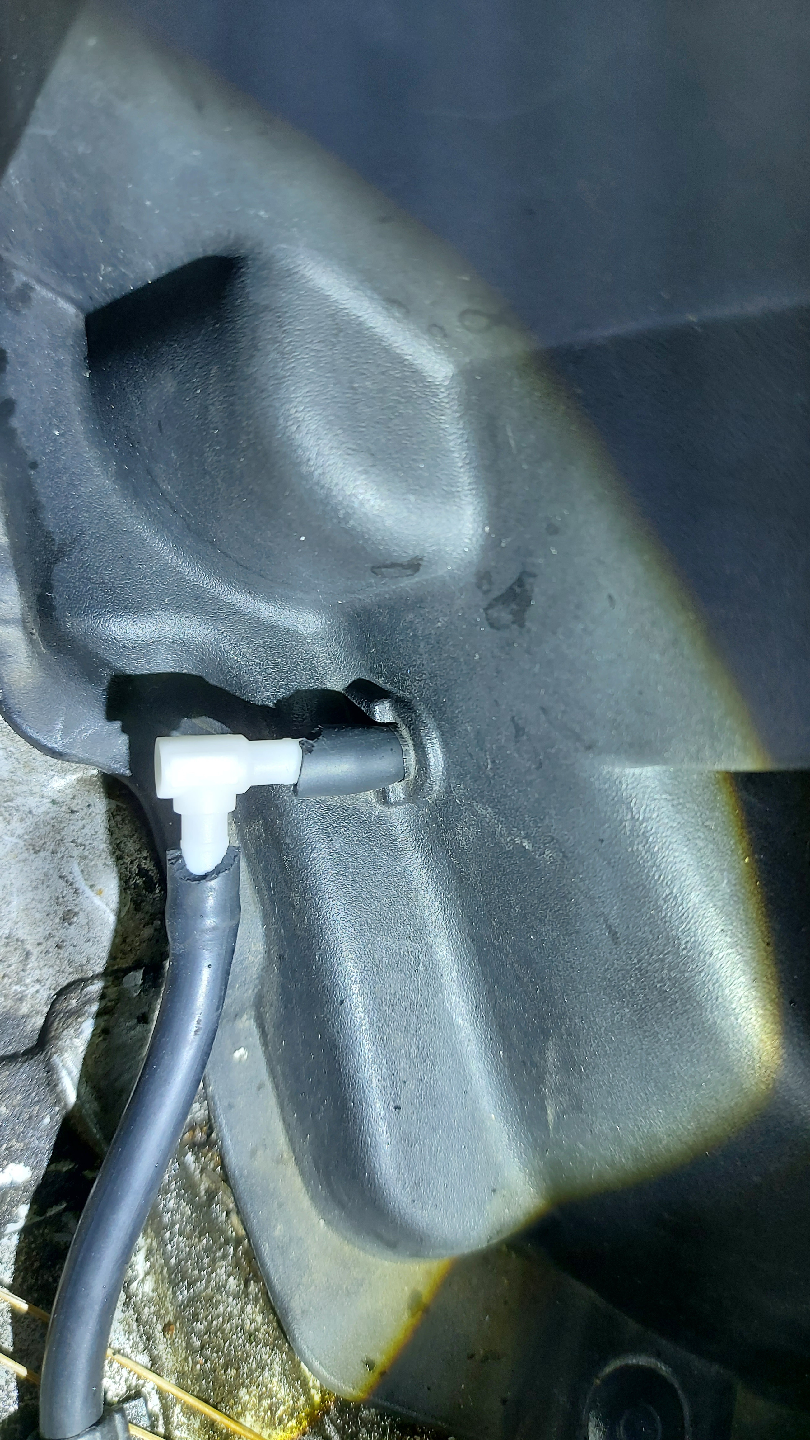

In the meantime I pulled the plastic pipe out, at the point where it enters the plastic fascia, and found it was split.
Easiest solution was to buy an elbow connector in Halfords and reconnect after cutting out the split part of the pipe (the photo looks horrible, definitely needs a good clean under there)
