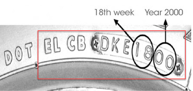

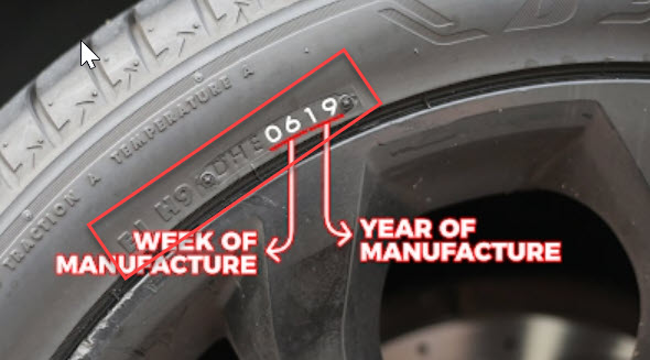

Tyres:  I'd check out the age of the tyres (including spare) and their condition to gauge whether you need to replace any and factor that in your costs .  IMO, even if the tread depth is legal, if the car wasn't mainly garaged i.e. subject to outdoor weather (dry rot) etc and/or has tyres older than say, 6~8 years old I'd replace the lot, but that's just me.
I believe tyres have lost their best after say, 5 years and that's with garaging and proper tyre maintenance/inflation, but that's me because I'm a bit tyre-fussy.
Tyre manufacturing date:
Bridgestone (Australia)
:link: Tyre Age - Tyre Expiry Date | Bridgestone,and%20if%20they%20need%20replacing.
Summarised: If the tyre was manufactured after the year 2000, then you can determine its age by looking at the last four digits of its tyre identification number on the sidewall. These are the week the tyre was made, followed by the year. So, “18” would indicate the 18th week, and the “00” would indicate 2000 i.e. manufactured in the 18th week of 2000.
  Mfg 6th week in 2019
