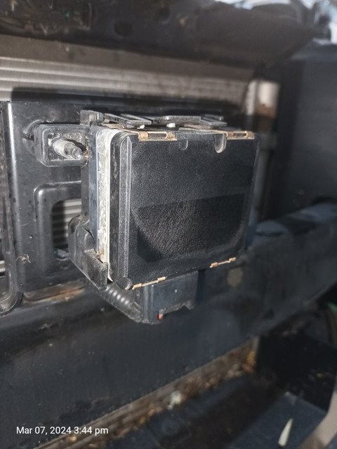

The radar was eventually diagnosed as being out of alignment due to 'damage' as the service centre observed a 'small indent' on the radars front face. But on inspection, I was unable to see any evidence of this and there is no damage to the front bumper behind which the radar sits. I took a photo of the radar (attached). Interestingly, there is some sort of circular 'rough surface' pattern on the radar which is only evident due to the flash I used. I couldn't see this without the flash. The 'indent' is to the lower left and side of the radar and is outside of the circular rough area. Could this be part of the normal condition of these radars or has there been damage at some point either before or after sale?
The radar alignment was corrected (~AUD600) and we were advised to drive the vehicle to see if this fixed the issue. We have not been able to do this yet as it requires a significant period of travel. The service centre refused to contact the Hyundai technical division despite admitting that the radar realignment may not fix the issue. Warranty was also refused due to the 'damage' and we were advised that if the system was still faulting, it would be a ~AUD6,000 repair bill.
