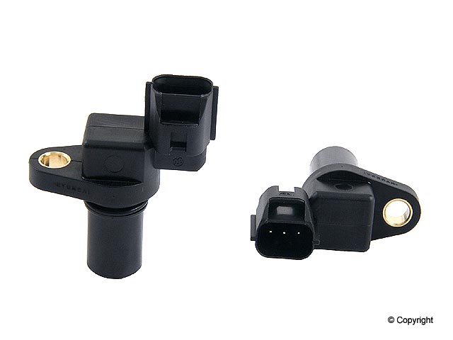

Nothing is ever simple. here's the list of sensors all compatible with this one,
Output shaft speed sensor
   4262039051   SPEED SENSOR SHAFT PPC
   4262039100   SPEED SENSOR SHAFT PPC
   4262039200   SPEED SENSOR SHAFT PPC
Input shaft speed sensor
4262139052
4262139100
4262139200
And some pretty images on locations. The parts numbers shown are two suitable examples on this box.

A hard knock ( impact) you describe would not normally cause this problem . Its probable that past repairs have left some wiring that is vulnerable eg. insulation stripped , therefore it shorts out.
The turbine speed sensors (pictured) are wired in parallel .
 They have three leads; the same 12v supply goes to pin 3 on the front and the one on the back of the trans. They have a common earth (pin1).
 Pin 2 are separate signal lines to the PCM.
You say you have exchanged the PCM and find its ok.????
In normal use a sensor will draw little current; so to cook it, you have to short pin 2 to ground or to the 12v supply.
So I would be looking at the plug on the burnt sensor, the wires are close together, if it has been stressed they could touch each other.
The sensor may have been cracked before you thumped it. But you will need to put a meter on the wiring before you replace it because it will cook again.
As said..just thinking hope this helps. :)
Thinks!!!!!!!!!!!!!!!!! :confused:
