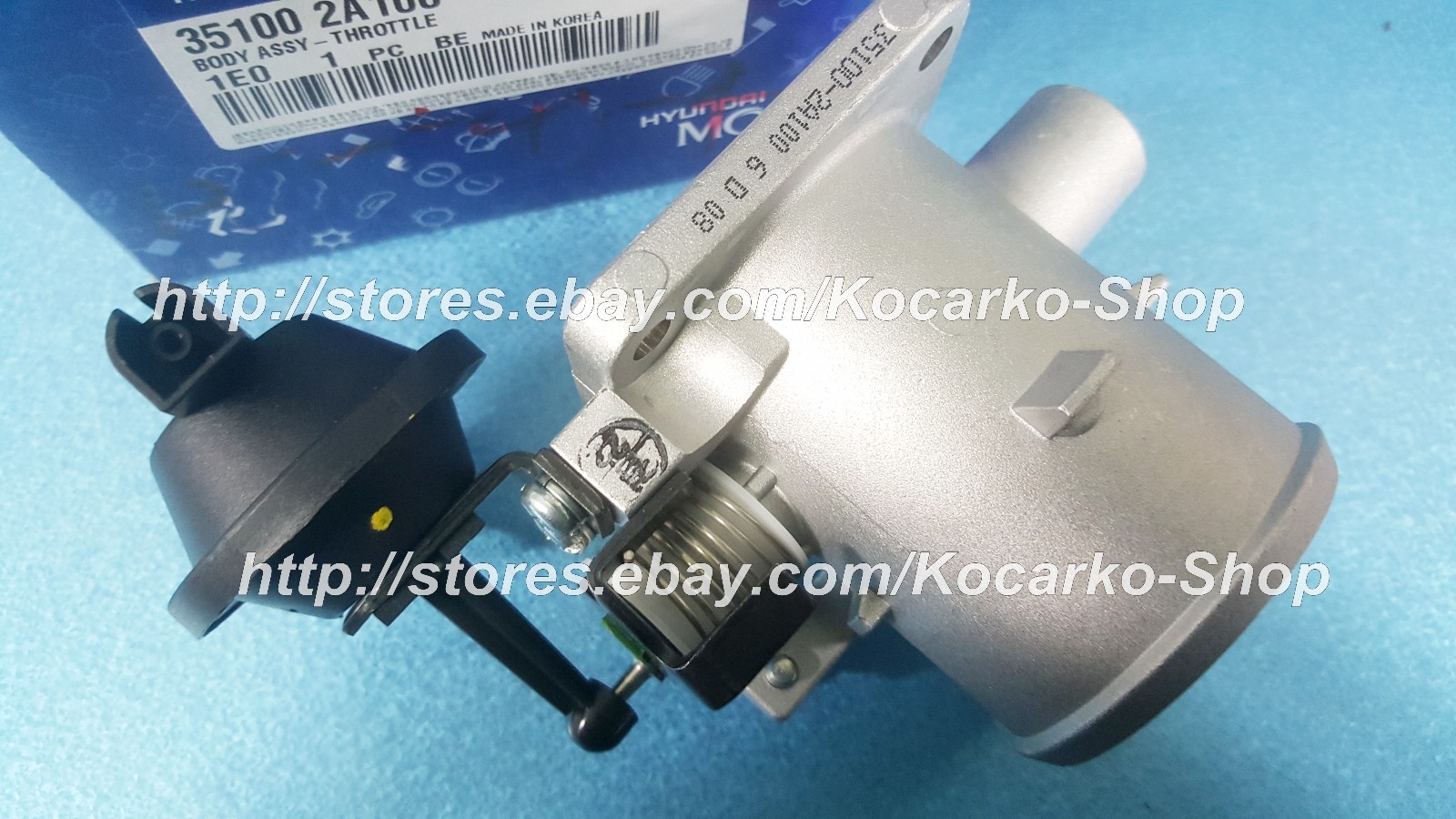

It now runs thanks. Just needed more priming. But it will only run when a little vacuum hose is disconnected. On the end off the inlet manifold That little valve keeps shutting. Any idea?
  • 09/2007 i30 diesel
Wild card guess, solenoid with vacumn lines above oil filter, is that connected? I don't have my manuals to look deeper @nzenigma  may be able to dig on this one. yes that's the anti- studder  or run-on valve so the engine shuts down cleanly for want of better words
As you have discovered (re Gumtree) I am psychic, however, I'm at a loss  :phone1: so could you send photo of your little valve .
Diaphram that sits on the side of the TB, can't miss it. Open when running but is closed at shutdown to choke engine. similar to this
hardly a little valve so I wait. Think he needs to crack a line to get rid of air.

It won't let me add a pic. Bit yes that is it in your pic
definitely connected to that solenoid controlled vacuum valve.
I think that's the one, has electrical connection too.
