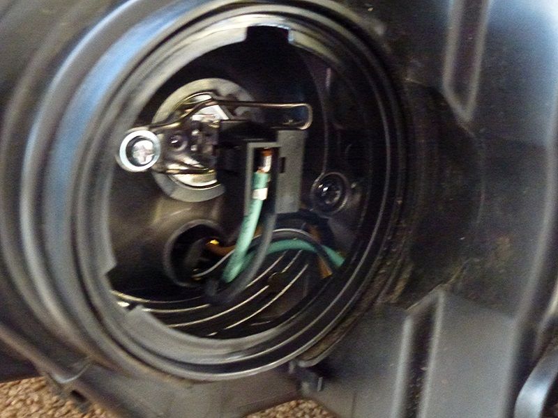

I've upgraded my H7 bulbs easily enough, could unclip the H1s no problem either. But the sidelight wouldn't pull out, felt like it was welded in there! Is there a clip I am missing - black plastic unit the bulb sits in appeared to have a couple of notches....

I'd remove the complete headlight unit to give you better access, this only takes a few minutes.....
Offline Skiffie
    • Posts: 8
      Brisbane
Got that - it's removing the holder for the T10 that's the issue.
  • 2011 SX Auto, Vivid Blue - bog standard!
I just ripped my headlight out to check and the parking light holder just pulls out...hardly any effort required at all on my 2010 FD...  :undecided:  :whistler:

Huh!   :head_butt:
At least from the photo I now can see what I'm up against.

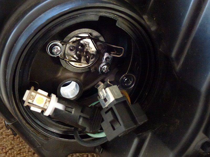

The whole process of changing the H7 low beam and T10 park lights takes less than 30 min each side.
To take out the front park bulb (t10) just use thin pliers and pull the base out, you can also do it by hand they should come out quite easily.
I replaced them with blue LED T10 W5W and they look like this: (if they do not light up reverse them as they have polarity - make sure to do that BEFORE you put the light frame back on):
I got them from ebay :link: 2 X Blue T10 LED Light Bulbs W5W 194 168 501 Dash Park Interior Number Plate | eBay
and the H7 bulbs are so expensive in Australia in retails stores, even the Narva's from supercheapauto are close to $50 dollars. I got these from ebay: :link: Hyundai I30 Grandeur Sonata Terracan H7 12V 55W Globes Xenon Headlight Bulbs | eBay
