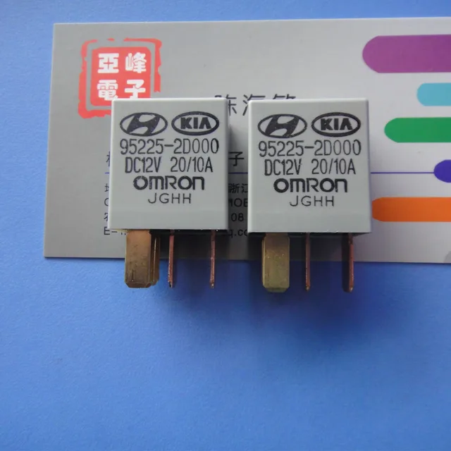

952252D000
wiper relay, located in main fuse box, the lid will have the labels, only one of that type in there unfortunately so you can't swap another for a quick test but looks to be a common relay in Hyundai / Kia if you happened to have another to borrow from.

You could take an image of the box and post it. I'm assuming the fuse box is fairly generic across the models. pretty sure it's labelled in the lid and has FRONT WIPER RELAY

i've located the relay, and will be testing a different one from a friends i30.
i also found a bosch relay with same relay specs as the original. would that be alright? since the original is difficult to find in any danish shops.

If it's same spec same size same pin out then it should work.
Specs are what determines similarity, the more the better. Feel free to post a comparison and we'll comment.

Relay did the job  :goodjob2:
