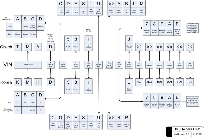

Following the demise of version 1, here is mark 2 of the i30 VIN decoder. Feel free to reply with any corrections or additions.
Get a high-res printable copy here

Congratulations on a nice presentation.
Spot on for my car which is a new i30 1.6 CRDi manual Premium to be delivered September 2010
TMADC51SLBJ1XXXX8

Just checked my vin number and have the following which don't follows as shown:
Registered in mid Sept 2007 (Car released for sale in UK Sept 2007)
Built in Korea
number 5 = C  - Mine is a Comfort (base model) model. Is this the same as SLX?
Number 9 = R - Not 0-9 as shown
Number 10 = 8 - Not 7 as shown (When does 08 year start?)

Number 5 - I'll add a table for the UK ones built in Korea but it's only going to have yours in it until more folk fill in the gaps. C being a comfort doesn't make a lot of sense to me at the moment, so I cant guess the others.
Number 9 - I just need to copy some data down from above, that will be fixed shortly.
Number 10 - 8 is correct, up until this year the years start in the august before. so from August 2007 to August 2008 (approximately) the number will be an 8.
    • Posts: 3,471
  • Midlands, UK N-Line T-GDi
Ok thats it updated, the "R" is a bit of a mistery, lets assume it means RHD for the moment
Might need to press CTRL-F5 (in IE) to see the update.
Still plenty of info missing/blanks to fill in, particularly on digits 8 & 9.
So does this mean if I was to sell I can now say 2008   :lol: :lol: :lol: :lol:
Cheers for the up date.
Shambles - can you check your VIN as you bought your Premium model 6 months after me and see how it compares.

The VIN code for my October 09 i30 Comfort show a different TRIM code as below:
March 2010 code okay.
This does indeed mean right-hand-drive, Left hand drive is a "P" in the same field (updated in 1.3)
It could correctly be described as a MY08 (Model Year) but the MY designation can be pretty confusing (take the MY11 being available in the UK since April this year doh!)
    • Posts: 3,471
Hmm. My MY10 (A) Style variant is also a C. I guess the messed up. I'll add both for the moment.

No.5 Model series.
My VIN has C but is UK premium model 2008. so must cover various models.
    • Posts: 3,471
That field seems to get a new meaning each model year. I guess 2008 was the same as the MY2010 cars. I'll add that next time I do an update, thx.

I have just checked this against mine and I also have the C at digit 5 for an MY08 Premium.

My i30 is listed by the dealer as a MY09 but it has an A in the VIN which means a MY10 according to your decoder. Prod date is 01/09/09.
  • 2009 2.0ltr i30 GLX
Vehicles built in September are often the next model year (so that is quite possible) :goodjob:

My 7th digit your post claims is always a 1, but mine has an A.  Any ideas what that might mean?  That it's an Elantra Touring not an i30?
Also, my 9th digit is a 5 and your chart labels this as a 'check digit'.  I don't understand that, can you clarify?
Just for reference my Model Series (digit 5) is B and in Canada my Elantra Touring trim level is a GL.  They sold three trim levels, this is the middle, the L, GL, and GLS.  Edit:  This was in the 2010 model.  I see right now you can't buy an L trim level.
Any further details needed?

My 7th digit your post claims is always a 1, but mine has an A.  Any ideas what that might mean? Lorian who started this thread Didn't come on for over 12 months although he did make a quick surprise visit the other day  That it's an Elantra Touring not an i30?
Also, my 9th digit is a 5 and your chart labels this as a 'check digit'.  I don't understand that, can you clarify? Wiki explains it better than I can..
"A check digit is a form of redundancy check used for error detection, the decimal equivalent of a binary checksum. It consists of a single digit computed from the other digits in the message.
With a check digit, one can detect simple errors in the input of a series of digits, such as a single mistyped digit or some permutations of two successive digits."
With a check digit, one can detect simple errors in the input of a series of digits, such as a single mistyped digit or some permutations of two successive digits."[/color]
