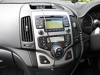

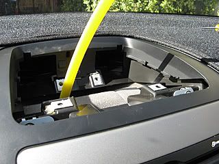

I decided to mount my GPS in the top pocket on the dash as suggested by others.
I didn't want to take the dash apart so i just took out the top pocket and fed a piece
of plastic down the back of the radio to pull up the power cable.

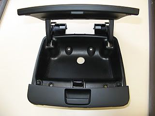

I drilled a hole in the pocket for the cable to come through.
I tied a loop in the cable to stop it falling through the hole
the GPS is attached to the lid of the pocket with velcro. The weight of the GPS is
enough to hold the lid down.
I road tested the mod by driving over the local speed humps. Overall i'm very happy with
the outcome of this quick and cheap mod.
