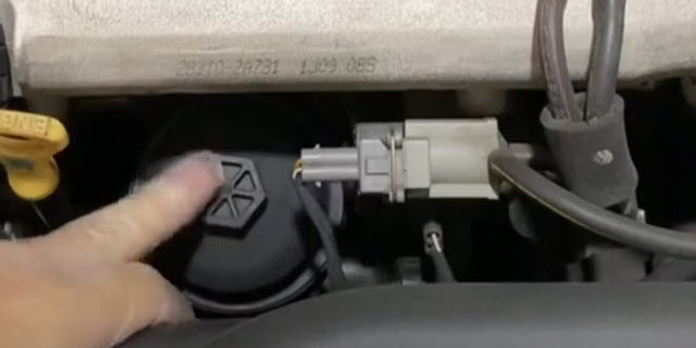

My oil  filter removal is blocked by some electrical connections...and I am worried about breaking something to  get it loose ..... Any tips.?
Also the filter needs a 27 mm socket. I was surprised at the odd number.....how many people have a 27 mm socket laying around? :undecided:
see photo

@Rae.  I found this on YouTube for Hyundai i30 CRDi 1.6 litre 2009 model.  Does it help or just confuse you more?  :neutral:

@ Rae.  Out of curiosity I quickly browsed a few YouTube videos and in most of them the oil filter was easier to access than yours (they were more like what The Gonz said in his post above).

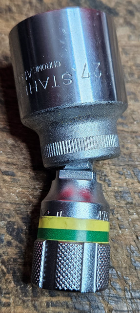

You mentioned: Also the filter needs a 27 mm socket. I was surprised at the odd number.....how many people have a 27 mm socket laying around?   Just us tool nuts!! :lol:
    :D
The above two 27mm sockets are from my roller toolbox, I think I have the same again somewhere in my track toolboxes (now well stored away and sadly no longer used).
If you intend to buy a 27mm socket but are still worried about clearing that plug connector, you maybe could use a 1/2" sq.dr. wobble extension which might offset the angle of attack on the filter enough to avoid the plug connector.
I've posted above a short 50mm L wobble extension and it would need a normal extension bar added to it to reach the ratchet.  Or,  you could just use one long wobble extension up to the ratchet.

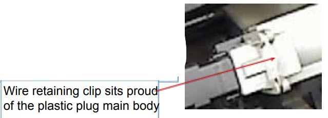

Mine is the same.
Just push the clip down, and it pops off easily. 👍

Mine is the same.
@Greenroome.  Your photo of the clip is much clearer than the guide I posted above and it should help Rae safely disconnect the part.  Thank you.
