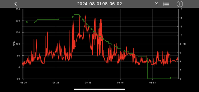

Hi all,
I bought a hyundai i30 1.6 crdi (2016) a few months ago, and I noticed that the dpf regenerates too often.
As I read the normal regeneration frequency is above 400 km, but mine do that between 130-150 km. I check the oil level in a daily basis and I think its not increasing.
I bought a cheap obd device to track the regenerations more efficiently. It shows that the regeneration starts at 14,7g soot level. The dpf differential pressure sensor shows a 220 mbar value when the regeneration starts. I attached you a screenshot about the pressure sensor values and soot load. When I saved the log I was driving on the motorway (2000-2500 rpm).
Do you see any unusual with the attached log? The soot load and pressure values are normal? Where should I start to solve this issue?

There isn't an issue, mine does the same, I've done 20k miles and not had a regen problem, if the car drives fine and there's no regen error codes it's normal.
Its really annoying that the dpf regenerates 30 km from every 150 km. Due to the additional fuel consumption my average is 5,7 l / 100 km. I think its bad for a modern diesel (mostly motorway respecting speed limits).
Its also not easy paying attention to not to stop the car when the regeneration is ongoing so frequently.
Its definitly a problem to me and i want to solve it.

Checked mine over last couple of days, it regenerates at around 16g of soot, it regenerated at 30 miles twice during town driving, I had to drive along a dual carriageway to allow it to finish, on the motorway it regenerated at about 36 miles.
This doesn't appear to be normal but there are no error codes or problems apart from the fuel consumption going up during regeneration, it's more than likely always done this in the 20k miles I've had it, now on 105k.
After lots of searching it appears there's no cure for this, I will just wait until I start to get error codes then either clean the dpf manually or replace it, in the meantime I'm checking a few things on the car like boost hoses etc in case there is a cause.
