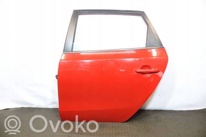

Here's an example of a door with such a plastic insert:

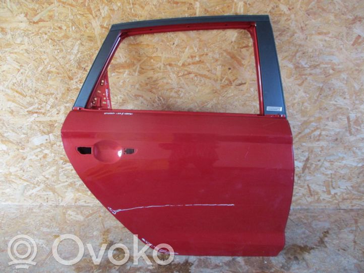

And here's an example of a door-frame only, without any plastic insert (or glass, or door handle):
