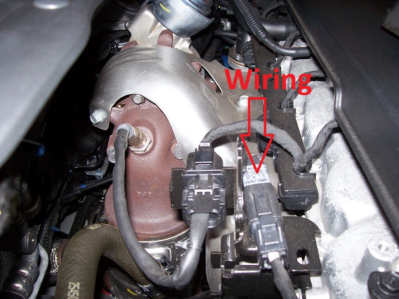

Some of the pics came out ok:
Relay box showing 80A Fuse and 70A Relay. (Think they got that the wrong way around, the fuse should protect the relay!) The fuse has a small lense on the top so can be visually inspected without the need for removal or a multimeter.
I'm kinda suprised at the ratings, as GSW indicates 4 glowplugs could draw as much as 100A. Probably out of date info.
This one shows the wiring connector that goes to the glow plugs. I'm still sure there is 4 there, even though its only the first one thats visible.

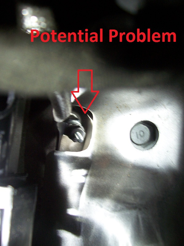

And finlly the only pic that came out of the plug itself. You can see where the heatshield could potentially cause an accidental earth to the plug. I'm sure water here would cause a prioblem, but the proximity to exhaust and DPF would sort that.

I have to be very happy that it was solved for me with just two trips to the dealer. Both times I left the car overnight so they could diagnose with a morning start. As I mentioned the first time they found the fuse to be faulty and by replacing this the problem was fixed, however it was not long before it reoccurred!
The fuse had failed again indicating there was a further issue and as it turned out it was one of the glow plugs shorting on the cylinder head. Lorian's picture of the 'Potential problem' probably shows best how this may happen.
As the smoke is essentially the result of unburnt fuel being forced out of the exhaust this, to me, indicates the glow plugs are not heating correctly. If the plugs have been replaced, which I understand has been the case in your car, this would eliminate these leaving the fuse or the relay as these are the gateway to providing power to the glows plugs allowing them to function.
Taking Lorian's suggestion I would definitely have the dealer test and verify the 'Relay' as well as the resistance across the plugs! Hope this is solved for you soon :)
I think the end of the heatshield from the DPF is closer than the head and the most likely thing to touch. If that's the case this could be something most specific to UK/european cars produced since July 2009 (U2s). This is pure conjecture of course.
