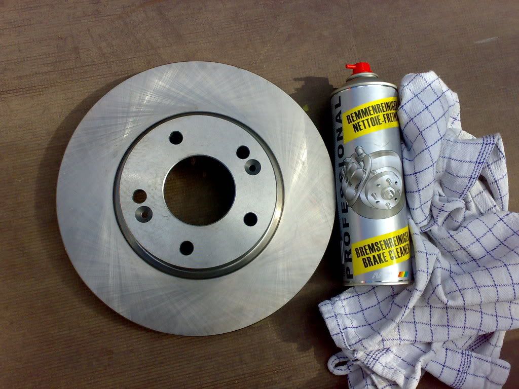

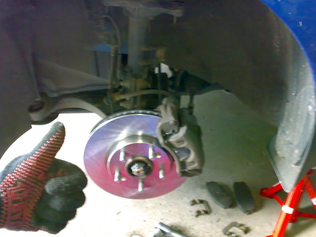

ehm no mate.... i thougth it was to expensive so i did not go for full replacement..  i got some same sized disc´s and pads .. just better materials... i added some pictures so u guys can see how its done if anyone thinking about doin it them selfs...  enjoy! :mrgreen:

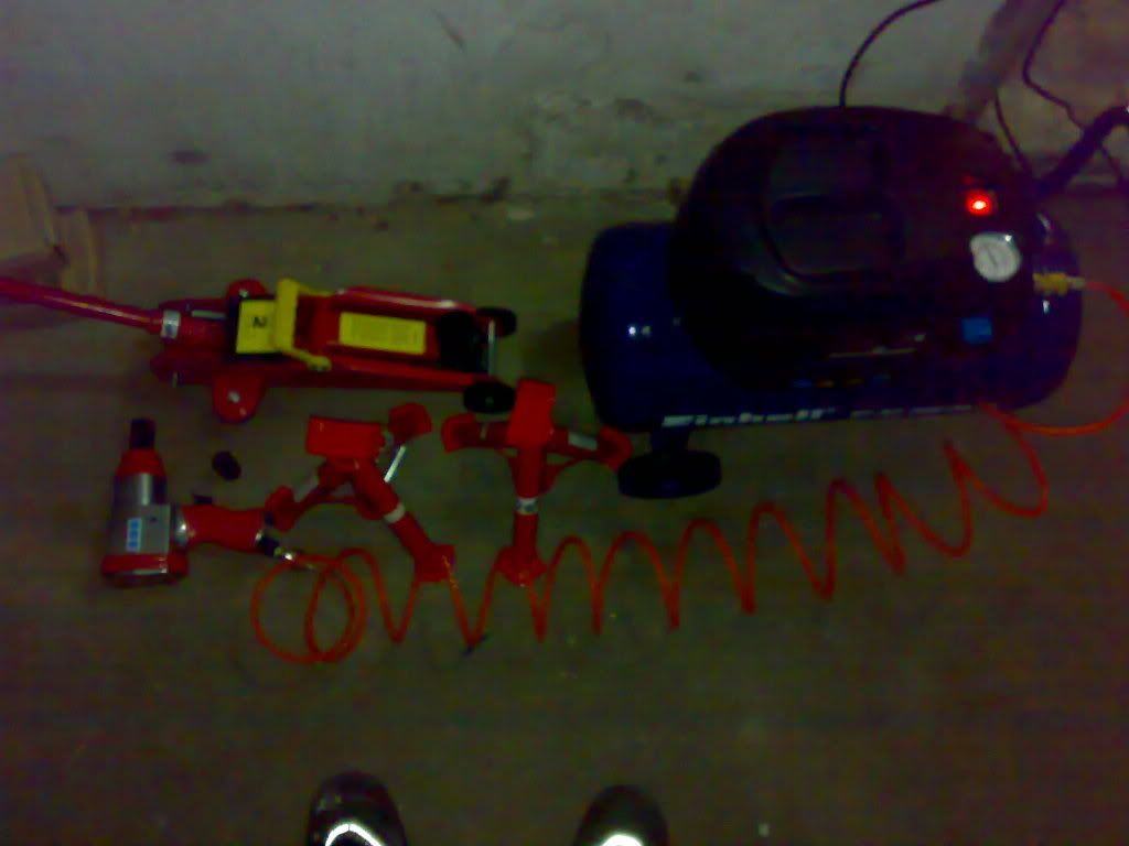

this just what i used to complete the job.

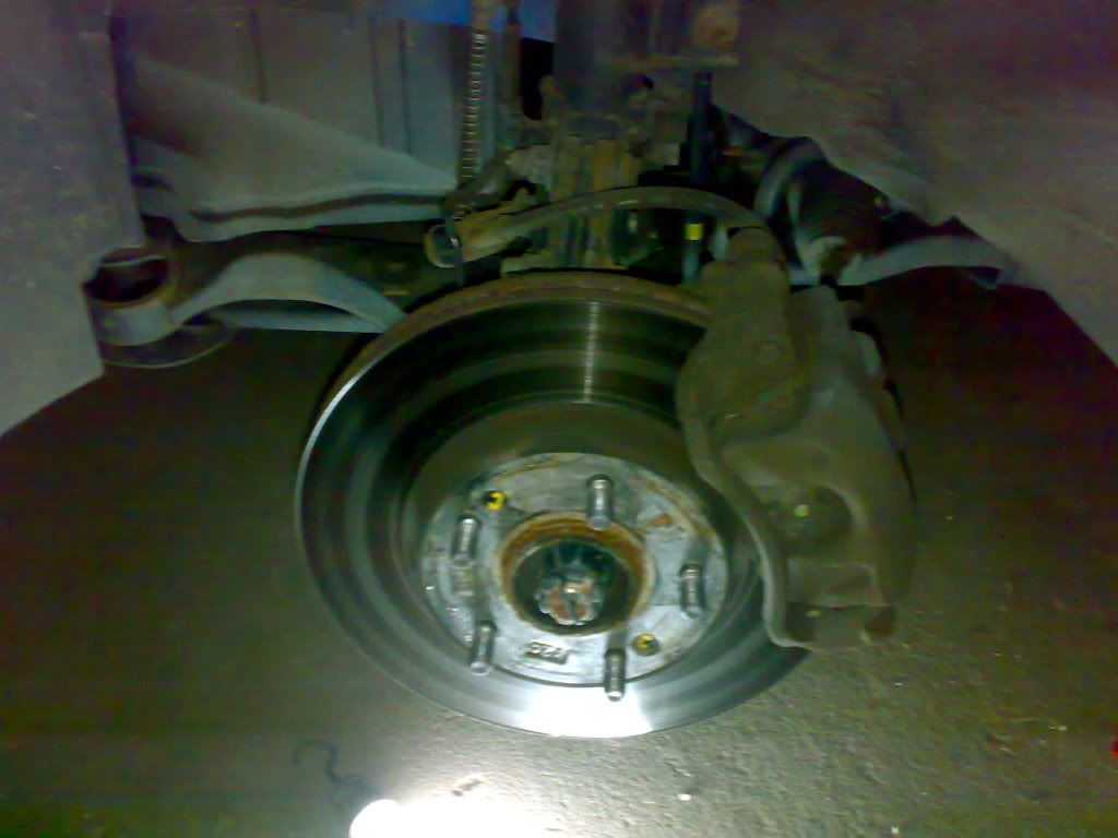

just removed the wheel using the air power tool.  .. yes... im lazy  :mrgreen:

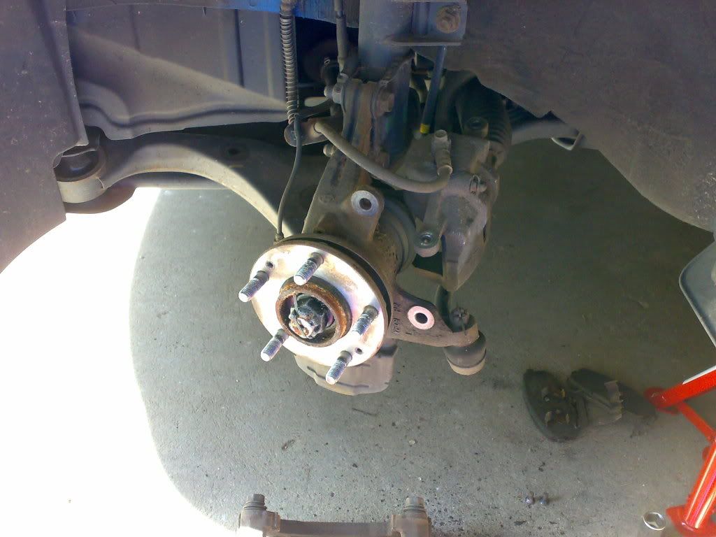

everything removed...  4 bolts and 2 screws r all u need to remove.

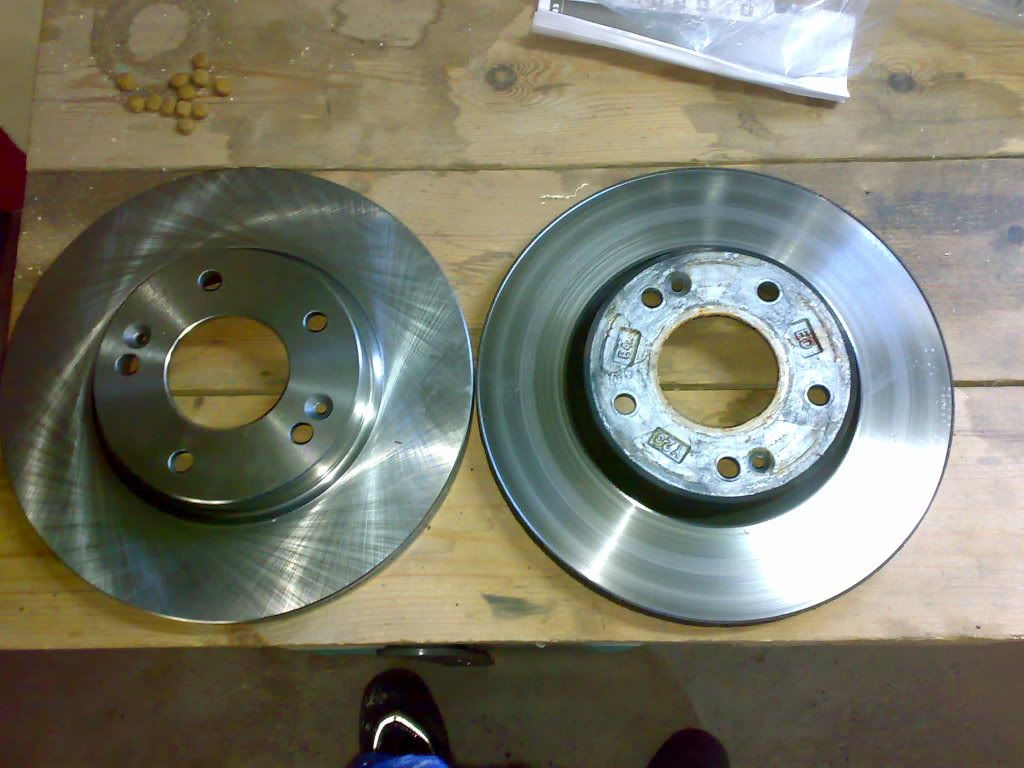

just to compare the old and new disc.
okay.. here we go.... when u change the disc´s u have clean the wheel hub very carefully.. all rush have to come off... use sandpaper.

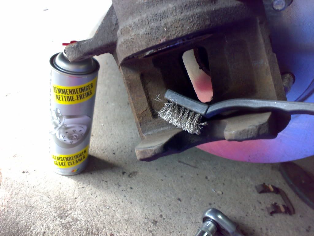

here i cleaned the brake pad bracket with a brush... do i very carefully and clean the rest with brake cleaner... :) as seen at the next picture.

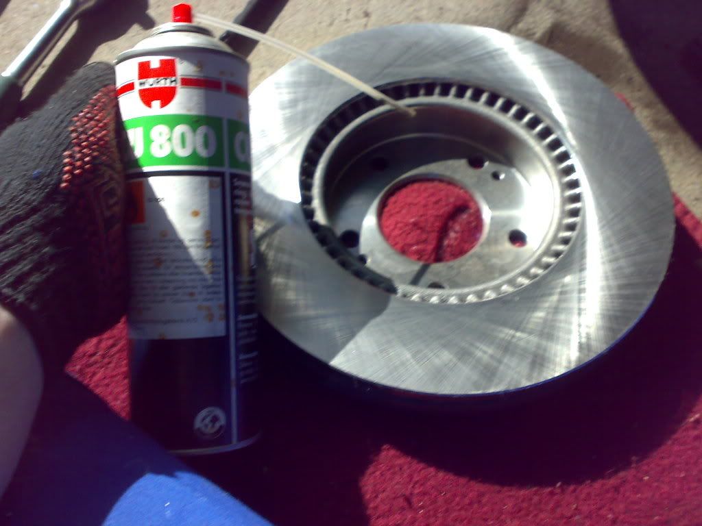

this is also very important... u have to clean the new disc .. all the rust proctecting oil have to come off... use the break cleaner again for this task.

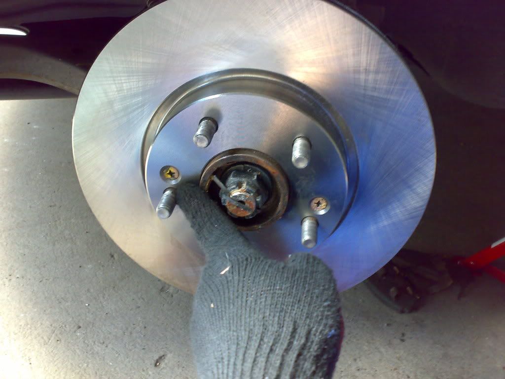

okay.. this not particular important.. but i like to do it... for one good reason... use never seeze at the wheel hub either on the disc side or just the hub... be careful not to get it all over the place.  oh and the reason why... its easier to remove again when need to change the discs again.
okaaay... these screws hold the disc inplace intill the wheel comes back on... give these never seeze aswell.. for easy assamble and disassamble.

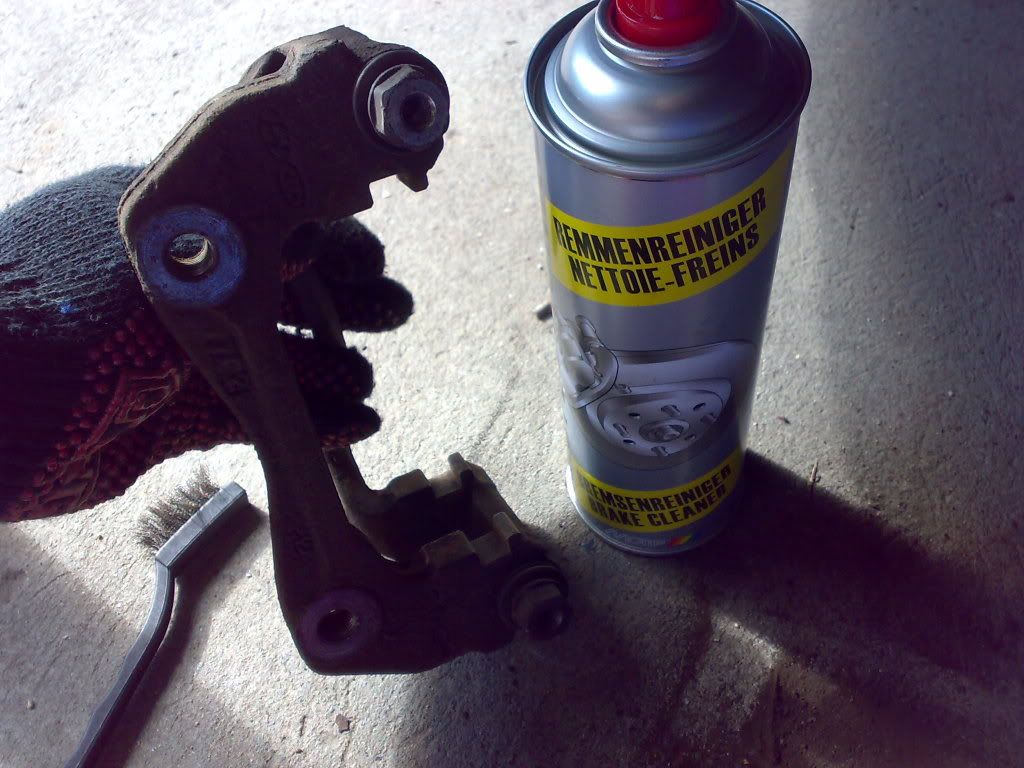

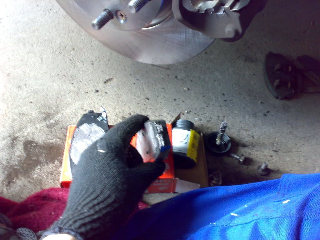

okay... this is the ticky part some will say... but heres the deal... use never seeze on the back side of the pads and where the pads r sitting in the brake pad bracket to make it move smoothly.
dont get it all over the place... its quickly gets at mess... if some of it come in contact with the pads them selfs... clean em with brake cleaner... same story with the disc´s  :P :P
here i have fitted the pads... use alittle force when u put em into the bracket..

okay .. this is just me . its not that important either.. but i like my brakes clean... use a brush and brake cleaner to remove all hard brakedust sittin at the caliber.

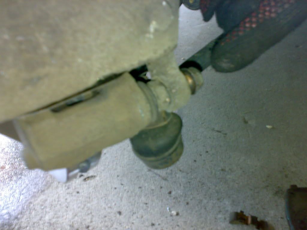

okay.. almost done now... just put in the 2 bolts.. im point my finger at one at the picture. and tighten it up....
