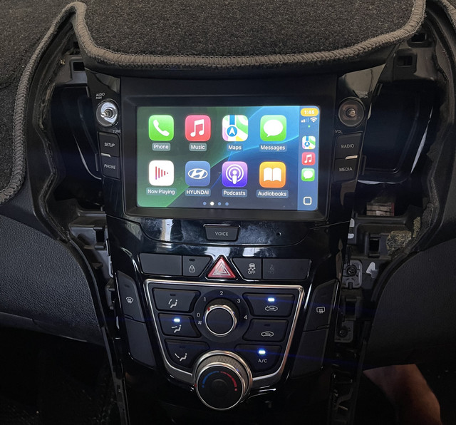

Just joined this fantastic forum to post my results:
I sourced a GD-03 unit from Ebay for about $300 and followed VTHs guide to install. As a lot of people have found, the usb/cable is a bigger issue than installing the unit itself!!
There is a quick workaround though - the cable Teegan linked to on Aliexpress does work. It's also available on ebay sellers with Australian stock for about $16. There are two versions so buy the one that terminates with the usb port.
Then, just plug the cable I to the back of the head unit and run the usb end down the back of the a/c unit and out the bottom of the fascia (near the glovebox) and that's it!!
The only parts that needed to be removed were the air vent trims and 4x screws holding in the head unit
