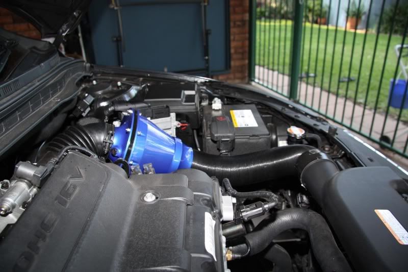

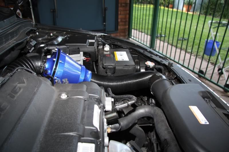

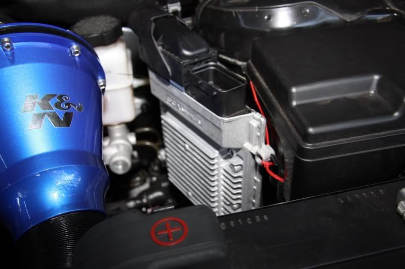

NOW PLEASE don't scream at me for attaching the ECU unit (please explain what this is...?) that was inside the airbox, with cable ties. It is more than sturdy where it is, there was just no other room for it!
The K&N air filter cost $250, and took about 30 minutes to install. Had to take out all the air box parts!

The ECU is the "Engine Control Unit".
Its the electronic heart of your car, it controls your fuel injection, tells your speedo what speed your doing based on sensors on the wheels, tells the HALO system to lock etc (although there *could* be a BCM (Body Control unit thats doing this , i havnt looked closely)) most if not all of the car sensors plug into this in one shape or form , i.e engine temp, fuel rail pressure, wheel speed, air intake temp etc the list goes on note the chunk of wiring that runs to it  :mrgreen:.
I dont think it was *in* the airbox before , isnt it just bolted to the side with 4 bolts ?
Just make sure its not going anywhere and that its no closer to heat and/or vibration than it was bolted to before.

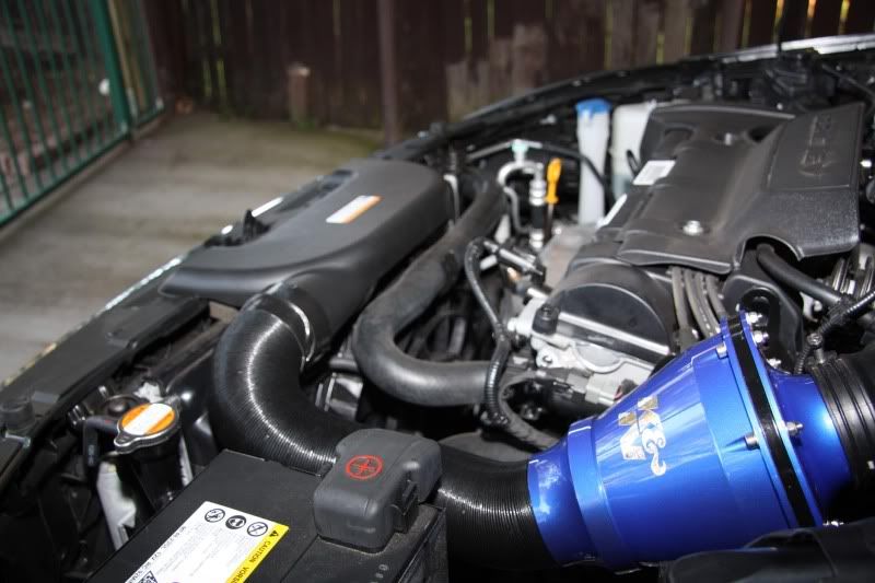

+1 point for ducting the K&N filter to the OTRCAI (over the radiator cold air intake) and not just leaving it limp in the engine bay to suck in hot air which cars DONT like, like so many other people do.

Sorry, I know what the ECU is, but I was wondering if that was the ECU or not. It has a heat sink that was partly in the airbox, but there's plenty of air constantly flowing through the engine bay, and it's going into winter, so no problems there. I just hope it doesn't get TOO cold, and freeze up!!
Yeah, I bought this Apollo kit because I knew it was fully enclosed, and the piping was the same diameter as the stock stuff. I had to gaffer tape the pipe to the over radiator intake because it was slightly too big for the piping.
Oops, yep thats definitly the ECU :)
