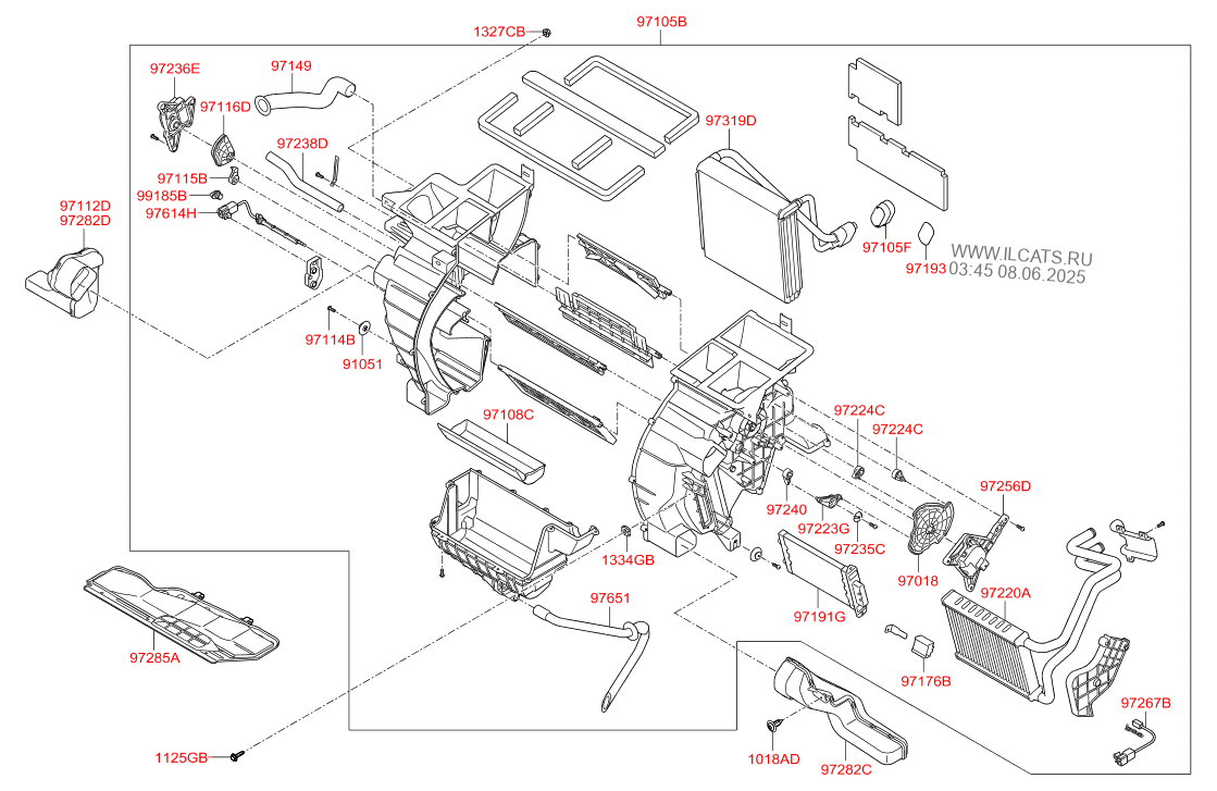

Temperature control actuator is located at the heater unit. It regulates the temperature by the procedure as follows. Signal from control unit adjusts position of temperature door by operating temperature switch and then temperature will be regulated by the hot/cold air ratio decided by position of temperature door.
Tough one to get images
far left item 97236E is the door actuator basically a flap . That'as where IO'd be looking whether the door is jammed, this actuator has failed or it's not receiving the commands from the temp control unit
