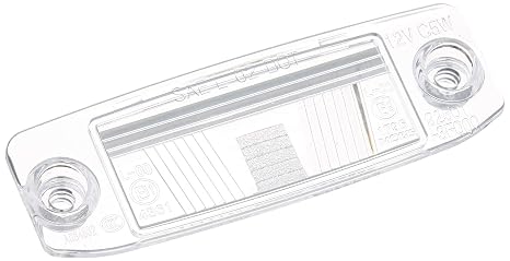

My 2011 i30 CW is coming up for its MOT in a few weeks. However, at some point in the past year or so, the plastic cover for one of the rear number plate (licence plate for future search purposes!) has come off, and taken the bulb off.
Does anyone happen to know a part number for this? I need to get it ordered and fitted in the next fortnight, and the local dealer quoted £150!!

Is this what you're after? 15mins it took me to find this  :head_butt:
92501-2L100

:link: ELANTRA TOURING 08- i30 i30CW 07- GENUINE LICENSE PLATE LAMP 925012L100 | eBay

SO I guess the 150 was the part only?
Just noticed the lens can ordered (maybe) Koraps don't list it.
92510-3F000

Thought I'd post an update.
Received the part from koraps within about ten days of ordering it, and it was indeed what I was after - £28 from Korea, shipping included!
Fitting was relatively straightforward - unscrew and pop off the tailgate trim, undo four bolts to remove the exterior trim piece that holds the bulbs. Disconnect the battery, and then the connector for the lamp units. Take the trim piece off, unscrew all the screws, disassemble, reassemble with the new bits. Reverse to complete.
