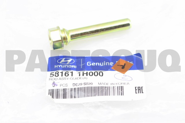

Offline BrendanP
  • Technical Advisor
    • Posts: 585
      East Midlands
I've had this problem on 2011 FD, front and rear calipers, and it's the glide pins that seize up due to corrosion. I replaced them with parts from Frentech UK. They include a sachet of special grease to lubricate the pins. It can be a real pain to extract a badly corroded pin from the caliper body. When it is out, try and scrape out as much of the rust from the hole as possible. They're not expensive, especially when the consequences of having them stick is premature wear of pads and discs, and if the caliper overheats it could damage the seals, leading to loss of braking effort.

I agree that salting could well be the problem - however this is the only car I've owned that has had caliper issues, and also know of someone who had serious caliper problems on her i30 when it was brand new.
Don't think its endemic or you'd see the evidence here.  Avoid jet washing the calipers as that can dislodge the rubber caps on the glide bolts and grease them every 24 months or so, just like a dealer WOULDNT do during a service. When I replaced the pads on my PD after 4 years the grease on the glide bolts was no longer effective.
