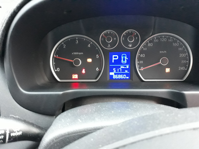

Update - I looked at the car myself last night and made these observations -  with the engine running the ESP light and ABS lights stay on.  Pressing the ESP Off switch does nothing.  Brakes are working fine though I never attempted to "test" the ABS.  The park brake light also stays on, maybe unrelated and only a switch problem.  I checked some fuses, nothing blown that I could see, but I did notice the upper section of the fuse board on the LH side under the bonnet was not fastened down by the 2 screws.  I tightened the screws but nothing changed.
An independent mechanic will be connecting a scan tool today to see what messages/codes are there.  I could also not make the steering unlock fault happen during the time.

Further update - checked and cleared all fault codes yesterday, they were all related it seems, to a wiring plug somewhere down the steering column.  As for the steering not unlocking, some lube was added through the key slot and that will be monitored.
