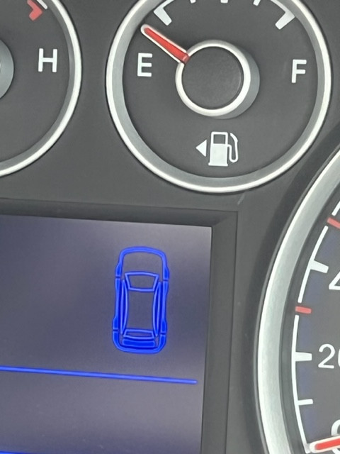

Hi team,
My daughter's 2011 2.0L FD i30 Hatch has a central locking problem, not like others I have read on the forum of not unlocking, quite the opposite, while parked and locked, the boot will unlatch itself setting off the alarm and similarly, when driving, the doors lock at 15km/hr as normal and then randomly the door actuators unlock the car (doors stay closed just unlock) and the boot unlatches and flashes as per the attached image. This occurs at varying speeds and even when idling at the traffic lights.
What we have tried:
* Disconnected the negative terminal on the battery for 30mins (multiple times)
* Replaced the car battery and installed new
* Replaced both keys (one genuine one aftermarket and recoded twice)
* Installed a new boot actuator
* Replaced alternator 15AMP fuse as it was not charging the battery
* Replaced the master switch assembly as the rear window wouldn't go up from the driver's door panel
In good conscience, I cannot sell this car with this fault and have spent a lot of $ with the dealer trying to diagnose the problem, which they cannot.
Has anyone had a similar problem or can point me in the right direction.  At the moment the Dealership has no idea and my wallet keeps paying them to tell me it is fixed when it is not.
I am really stumped.
Thanks for any assistance anyone can provide.

Hey The Gonz,
- does it happen in the same general area each time? No.  Sometimes it will happen in our street and other times after driving for over 30mins
- does it happen at the same approximate speed each time? No.  It happens at varying speeds but obviously greater than 15km as it needs to auto lock first
- does it ever happen when stationary? Yes.  When sitting at lights.
