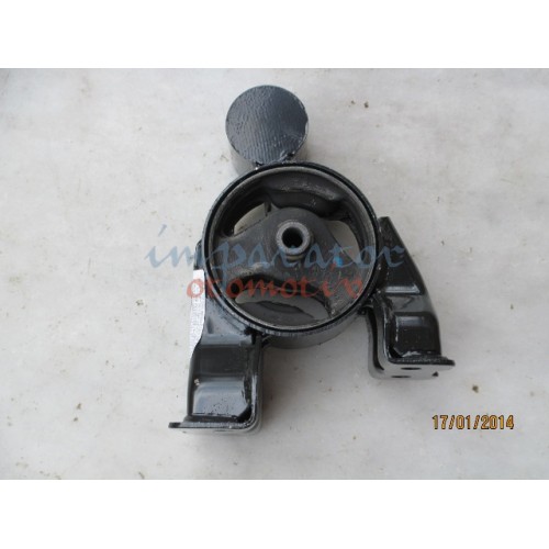

Edit: Well you learn something every day. I googled and these came up on Ebay! Not cheap!  :spitty: :crazy1:
:link: Motor Mounts for Hyundai i30 for sale | eBay
As you can see they are not just lumps of rubber. Some metal there  too.

This is a close up pic of the rubber in the trans mount. Quite a few splits and certainly on the way out.
