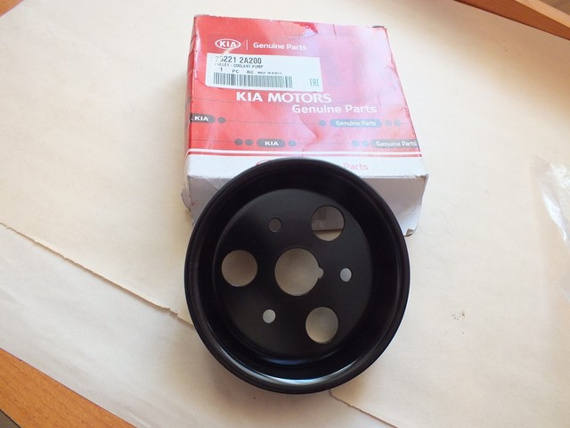

PULLEY - COOLANT PUMP [252212A200]
PULLEY - IDLER [252872A010]   item 25287U
PULLEY - IDLER [252872A000]  25287p
TENSIONER ASSY [252812A000]
You could get aftermarket pulleys including the one for the tensioner otherwise you'll have to get the whole tensioner genuine if  you want to replace that pulley

No idea on the suffix on the engine, can't find anything on that one, I'd disregard and use VIN and build data data
