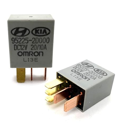

Thinking relay but don't have spare to check.

95225-2D000

You should check the relay. Remove, clean and insert back. Works fine over here.
