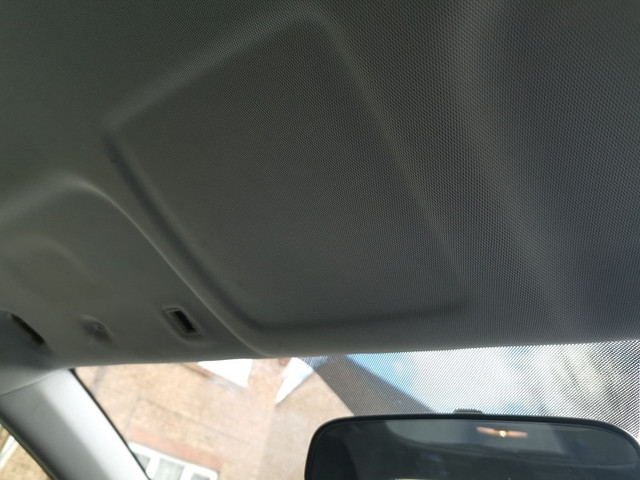

I've had a look in roof lining and this plug was taped up very close to where the light should be..  Fingers crossed.
To anyone who's changed the bulbs, does it look like the plug? Thanks.

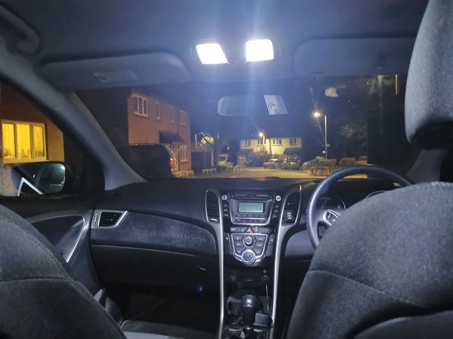

All Done, came out ok,  i think.
Light £31,  Bulbs £5, Wiring £10.
Superb job :goodjob:

That's an awesome effort for the money!  :eek: :goodjob2: :goodjob:
My kind of mod, well done. :goodjob:
