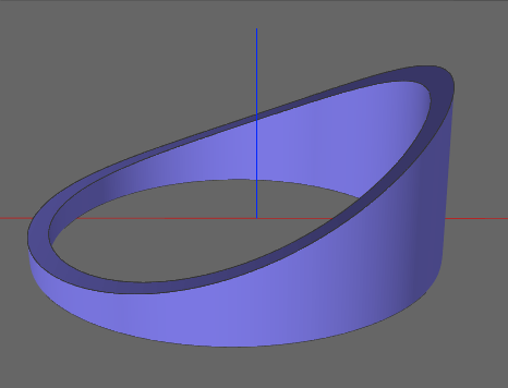

If you have time and patience, try changing the shape of your towbar with a cover and different materials, to reduce its radar cross-section to your sensors.
Also, try experimenting with a blinker lip on the side of each sensor facing your towbar. Think of it as the blinkers horses wear to focus forward. I suggest you use a small aluminium foil ridge taped at the edge of the sensor. Report your results with pictures.
I can 3D print an attractive and unobtrusive attachment based on your results.
Can you reset the distance that it actives act ?  :undecided:
You could, through adding a surface (lacquer or stick-on) onto the face of the sensor, attenuating it, but that may degrade its effectiveness where you most need it. You can't easily increase the detection threshold distance without getting into the electronics or software.
Hence I'm suggesting modifying each sensor's arc just enough. A picture's worth a thousand words:
« Last Edit: April 11, 2020, 00:54:12 by The Gonz »
Good work,
Sensor deflectors, hooks, key rings, who knows what's next  :goodjob2:
Retirment income  :victory:
