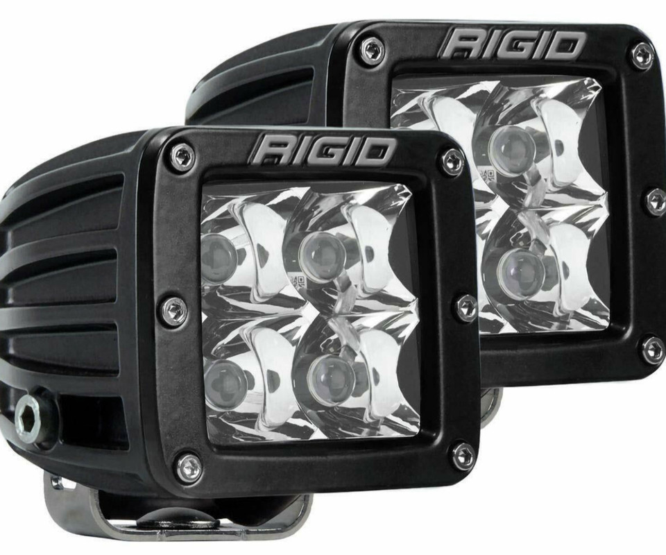

I had a couple of Rigid Dually Spots on my ST. They don’t have a long-distance throw but they fill in the sides of the road to give you more notice with movement in the bushes...
...doesn’t really help you if it’s daytime and they’re out and about, nor the last-minute suicidal leap of faith from a standing start.

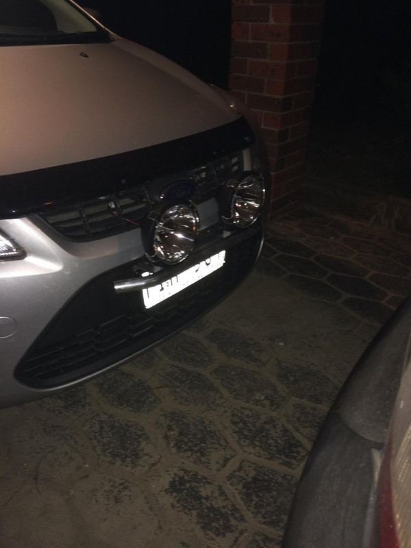

For what it’s worth (and you can tell this is an issue close to my heart) prior to my Fiesta ST I drove a turbo-diesel Focus.
Directly behind the numberplate was the crash bar, a local auto-electrician removed the front bumper, drilled two holes into the bar behind the numberplate mounting area, installed rivnuts in the bar, then replaced the bumper and screwed a numberplate bracket to the crash bar.
I had a pair a Hella Rallye 4000 Compacts with HID globes on this, the best lights I have ever had, and they were solidly mounted...which is just as well as they’re heavy lights.
I still have the Rallye 4000s and the Rigids, alas nowhere to mount either.
...maybe I need a 4wd.
