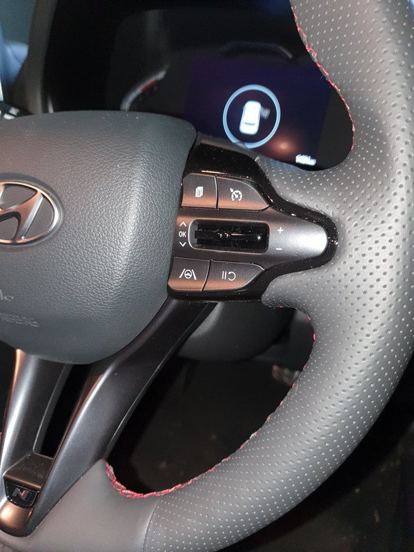

I went out and took a pic on mine, I gather because mine is (a) a manual and (b) a non-Premium model it may have a different set of switches.
Mine defaults to both on and I hold down the /O\ button to turn both off. A shorter button press allows you to toggle through different combinations and colours (and I have nfi what each does)...

Mine looks the same but I didn't know you can hold it down for different options?
Might go give this a try right now.
What colours does yours cycle? Mine just makes the steering wheel icon disappear/appear.

Right, just had a play and mine works as follows:
/O\ long press - turns off LKA / turns on previous option (assist or warning). Always independent to LCA
/O\ short press - toggles on/off LCA only
I believe our cars have different infotainment displays which is seemingly making control of this different.
