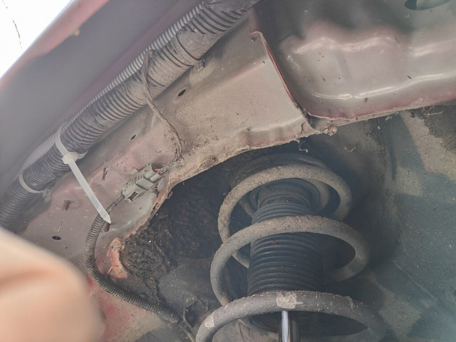

The conduit comes through into the wheel arch area. I secured it behind the existing black conduit. I ran the conduit over and down to the far side of the arch.
I cut a hole in the grommet, then fed the power cable through. The hole should be as small as possible to ensure a tight fit.
I put a dip in the power cable, to stop it from ever channeling water into the grommet.
Once I retrieved the power wire inside the passenger footwell (more on that later) and was happy that the lengths of wire either side of the grommet were sufficient, I applied hot glue to reseal the grommet as best I could.

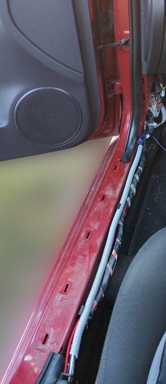

The power wire (outside the conduit) and various other cables (inside the conduit) running along by the front door...

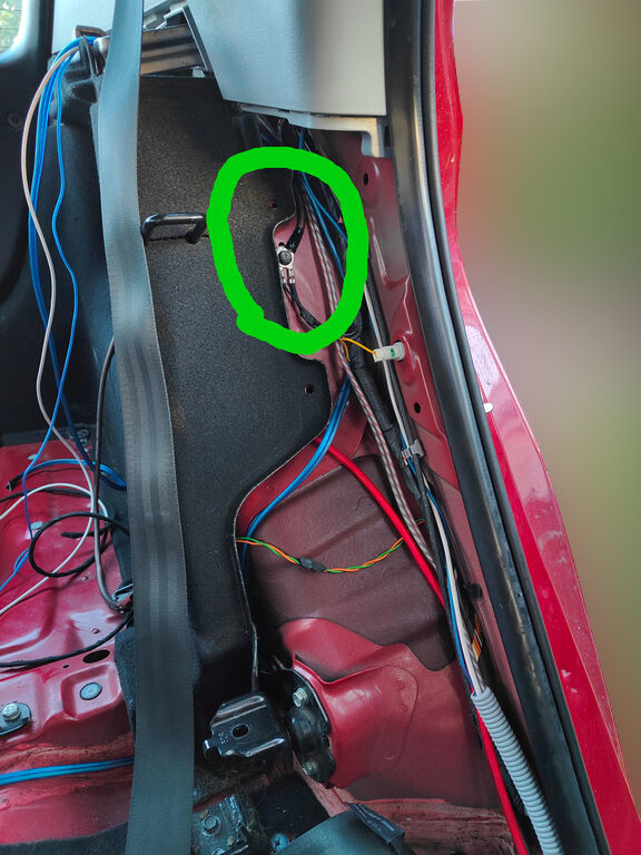

Encircled in green is a ground terminal with my subwoofer amp’s ground wire connected to it.
I was paranoid about red paint that was covering the surface where the electrical terminal makes contact with the car body, so I sanded the surface to bare metal, screwed the terminal back in place, then sprayed back over the surplus sanded area. Not sure if this measure was necessary and/or wise.

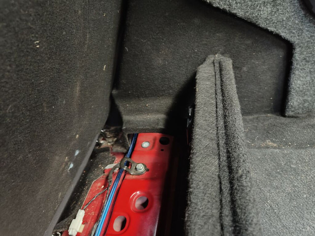

Subwoofer speaker cable, coming out from behind the left wall of the boot, across the floor of the boot...
back under the carpet at the right wall of the boot...
then out from a hole in the carpet where the rear seat backrest latch is, into the boot and straight into the enclosure.

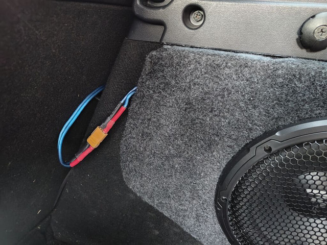

I installed this XT90 connector pair so I can disconnect the subwoofer easily. I later wrapped it all in loom tape for subtlety.

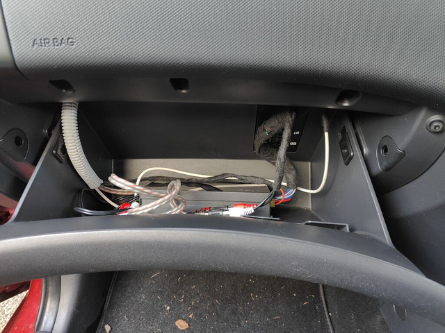

Wiring from passenger footwell to centre console
This is the amp which integrates with the factory radio and also talks to the subwoofer amp.
Cables in grey conduit on the left go down to the floor and on towards the boot.
White cable is the bass remote cable. It’s actually repurposed alarm wire. It goes off to the right and down, and emerges next to the cigarette lighter.
The rest of the wires are part of this amp, they go up and right to the radio.
