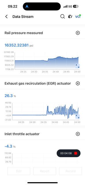

Offline Userlee5267
    • Posts: 7
      North Wales
Another 120 mile round trip.  No regen meh
Am I missing this happening do you think
