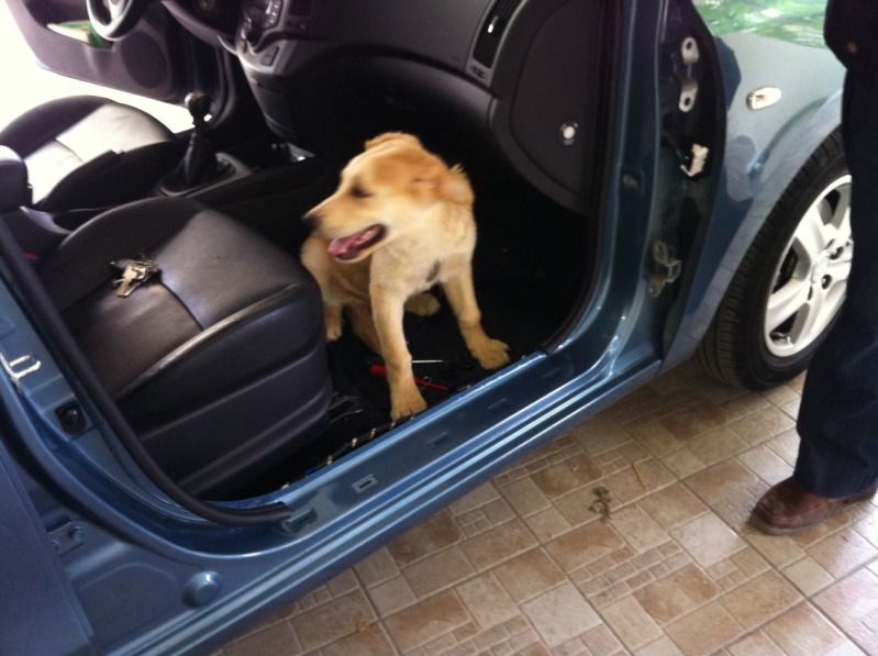

Yesterday I tried to lay a cable from the door switch into to door. But I failed to get it through the rubbertube. It's because I can't see anything inside the car. The hole for the harness which goes into the door is deep inside (behind) the dashboard. I even can't touch it from inside the car - unless I'll break my bones to get some additional joints :D
I already was thinking about removing the whole door - as I read in the thread now too. So I could start from outside, but than I've still no idea how to catch the loose end of the cable inside the car. So how do I get the cable into the door?  :mad: :evil:

Now with wrenched neck I know, that the plug connection to the door has 39 pins (3 lines each 13)! That's what I count from inside (did it triple to assure). The good news is that there are some unused slots. The bad news is that I now have to figure out what kind of cable lug (correct word?) is used.
I haven't imagine that there are so many wires.. though there are some slots left.

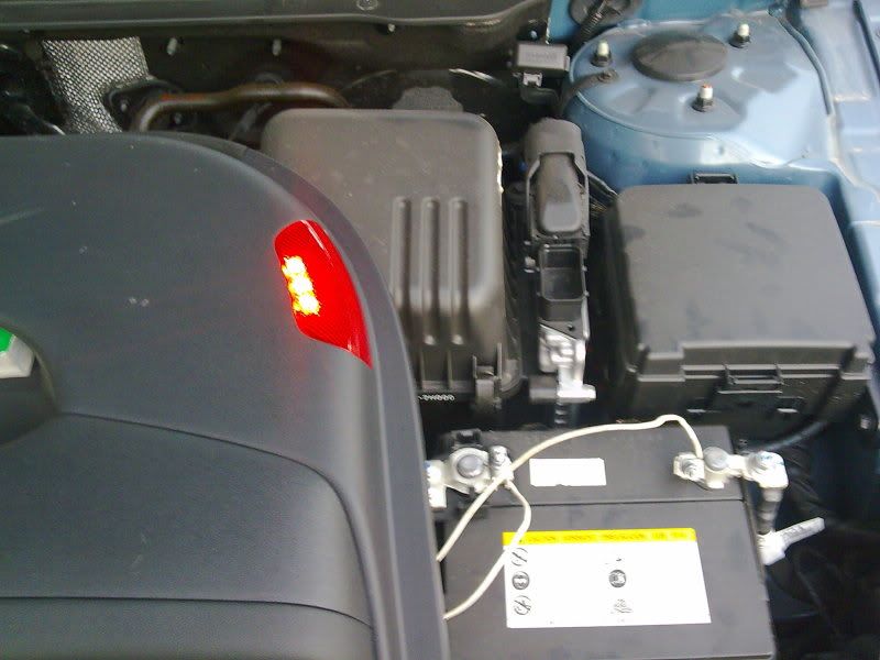

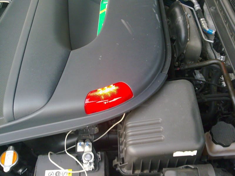

I will use this (3 to 6 leds for each door) and i'll take power from the dome light.
Offline nikitas i30
    • Posts: 61
    • gr Greece
      Athens-Greece
Do you like my project ?
Splendid!
You fitted a door card in your engine bay :eek: :lol: :P
Good work. Have you wired your doors yet?

Not yet hopefully tommorow i'll pass the wires inside the cabin and connct them to the dome light.

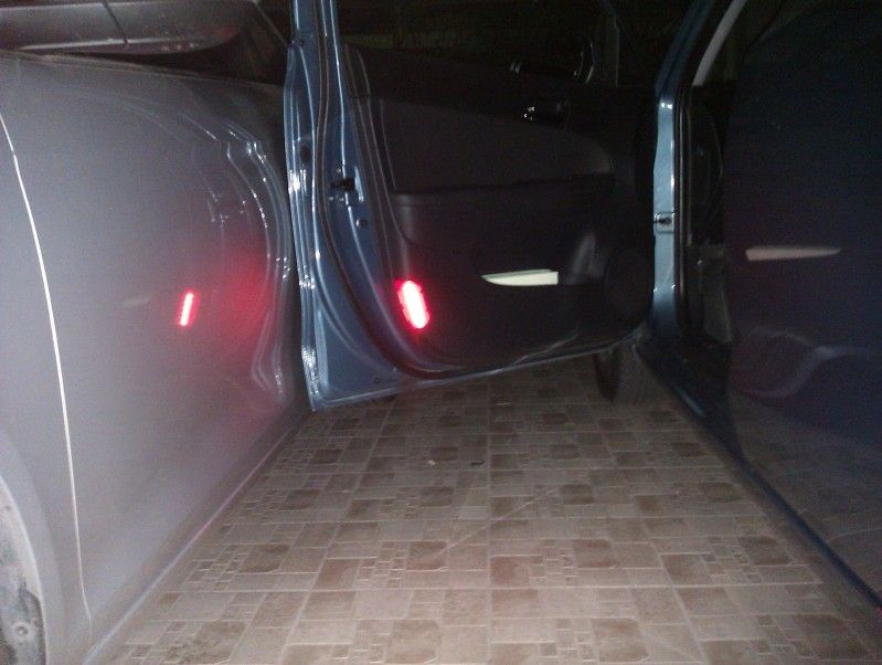

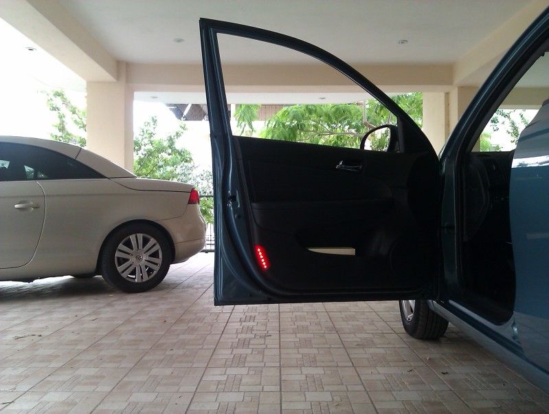

My project is ready!!! :goodjob2:
Do you like my door lights??
I just follow the steps of the first post,and i need to take out the doors.
It was needed for to pass through the harness the two cables.
