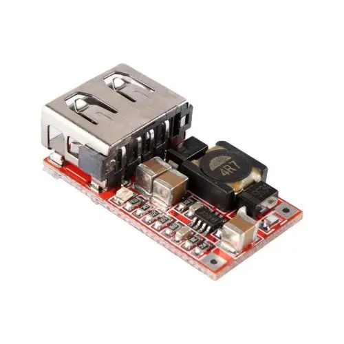

With the included black USB cable neatly and invisibly routed to the inside of the centre console and connected to one of my nifty $1 USB 12V-5V3A modules, the job is done and nobody would even guess that there is a wireless charging station built in.
ns
Now to await the arrival of my $1 charging receiver to start using it. Total outlay: $2 :happydance:
