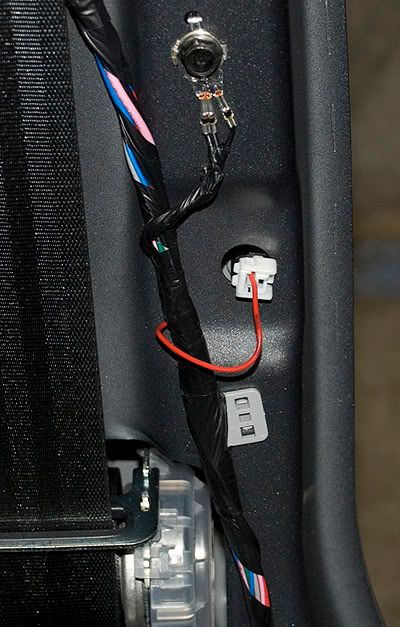

I had a look tonight at the wiring and just to get an idea how easy or hard this is, took a few pictures.

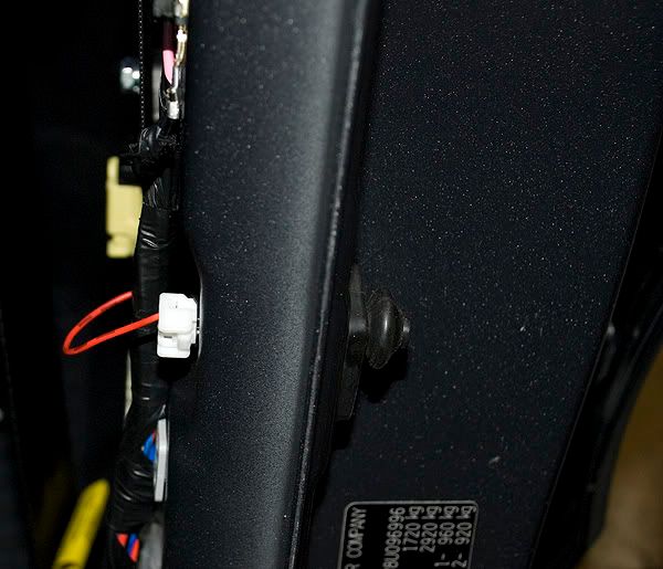

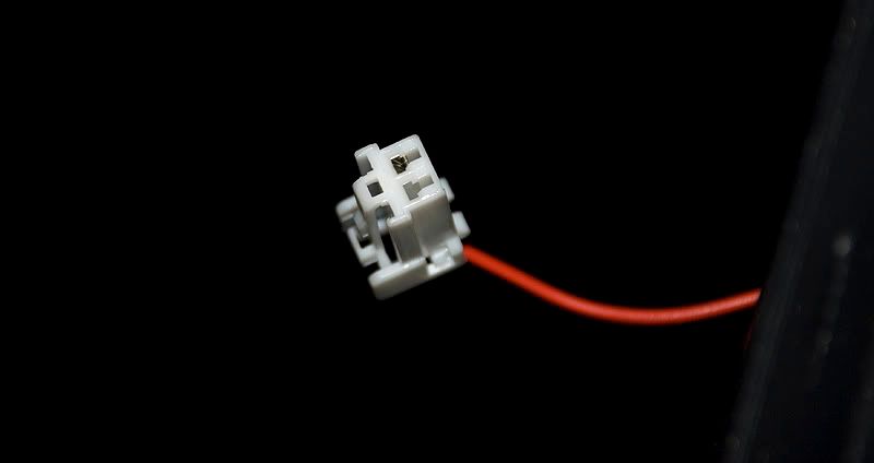

Here's the connector to the button that turns off the light inside when the door's shut,
The idea was to connect the new lights to this line, which has about 10V, but I dont understand why there is just one line in the connector, and there is always 10V on the line so I dont understand how this button turns the lights off  :|

Maybe it "earths" the wire to the body and completes the circuit once the door switch is open??
Does that make any sense?  Just a suggestion.

i'd have to go with seoul mate on this one... i think it's the earth (-) from the body, and it completes the - circuit when it is "turned on"/doors opened

you're right!
In nearly all cars you’ll find a single wire that leads to the switch. When the door is open the wire is earthed, so completing the circuit and switching on the light

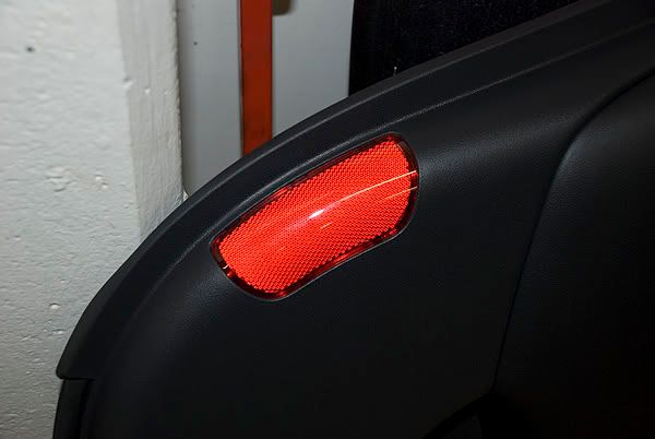

I thought about this mod too, as our Tucson has lights in the door edges.  At first i thought something was wrong with the globe or wiring in the i30 until i realised it was just a reflector.  i thought it would be cool to adapt a pushbike tail light - the flashing LED ones into it.  Might be a little distracting having it flashing every time you open the door tho.

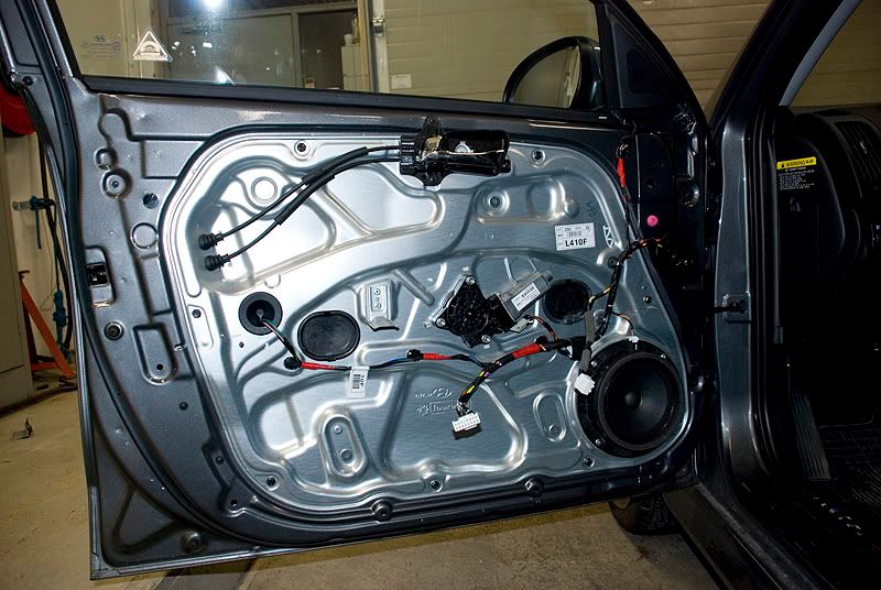

you have to find a positive. we take the red wire that is the main fat that is on the inside of the door panel.
the negative cable put it in another hole in this photo
just only you have to connect these wires to the bulbs or LEDs.

one advice
don't cut the positive only peeling for the conection

hi YOSOYPEPO, thanks for the reply, I still don't know where I get positive (12V)  :?

in the red zone you must to found this one red positive. is very fat than another.

really nice work!!! this should have been a factory built in item..but anyways, i wish you luck !

Poking the wire under the lip of the grommet is asking for a moisture leak i reckon.  Must be a better way to do it than that.   Nice look tho - I agree should have been a factory fit in the first place.
