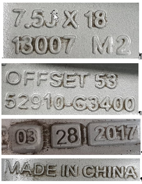

@ Brah.  I have a 2018 i30 SR, so presumably they the same oem wheels as yours unless the Premium model is different.  I also have a set of spare oem wheels (with tyres mounted).  My wheel specs are:
Size: 7.5J x 18".   PCD: 5 x 114.3.    Offset: 53.

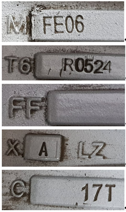

One day, out of idle curiosity, I recorded the specs stamped on the back of the wheel spokes:
Photo of specs stamped on one of the wheels on my car.  The first four photos imo are the main ones of interest for most owners.

Thanks for the reply Terry, I imagine "Size: 7.5J x 18".   PCD: 5 x 114.3.    Offset: 53." is the main numbers I need to know. Thanks for the help. May come back to this post if I find some wheels and need a hand determining if they are right  :goodjob2:
