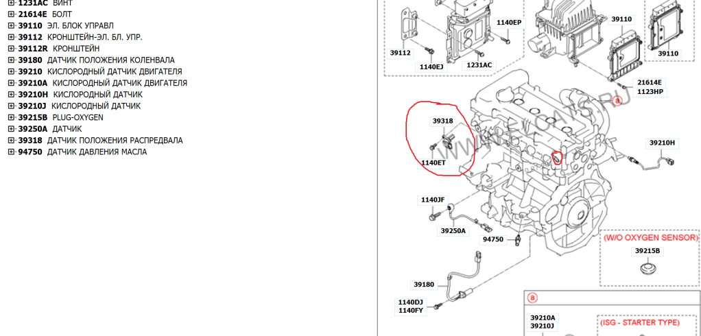

no, that highlighted thing is a camshaft position sensor
    • Posts: 43,395
Is it the flux capacitor?
Ahh right. I must have misread it :whistler:
Thx Misha
