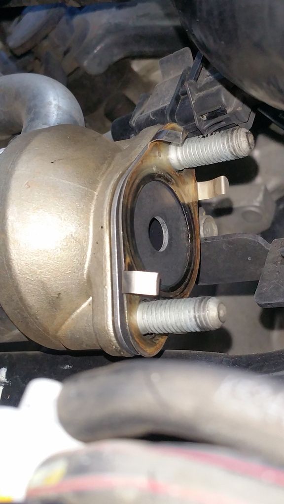

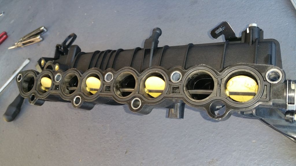

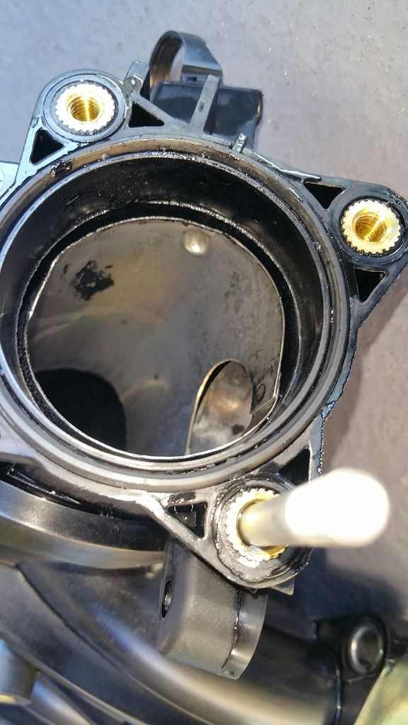

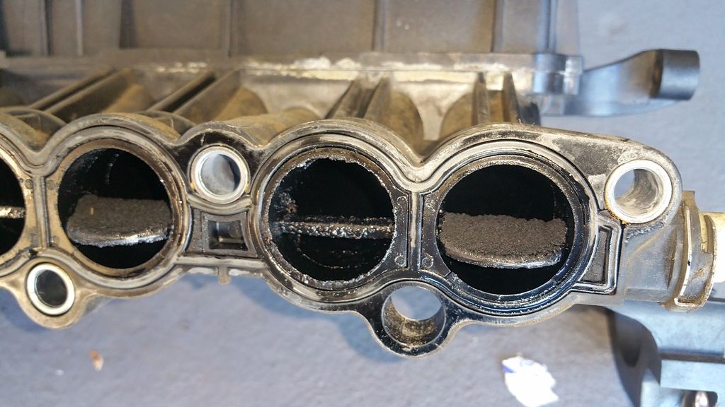

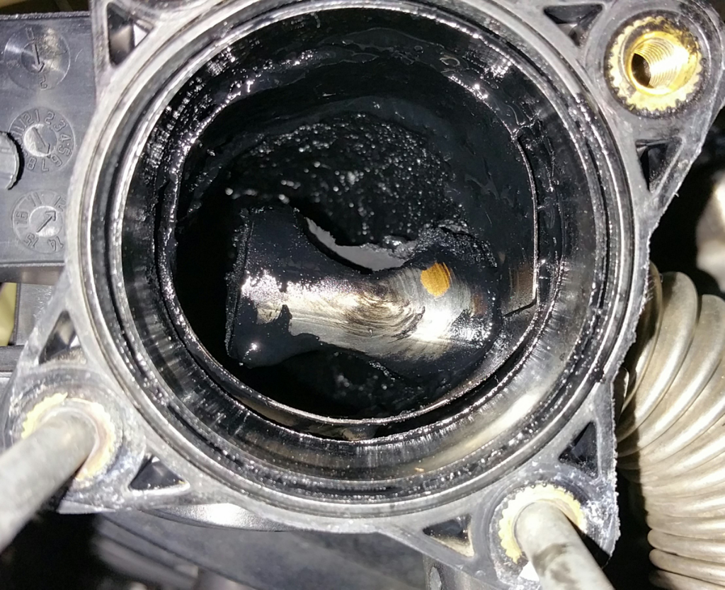

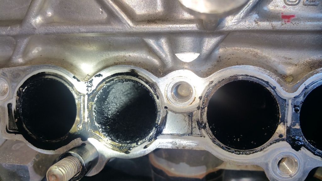

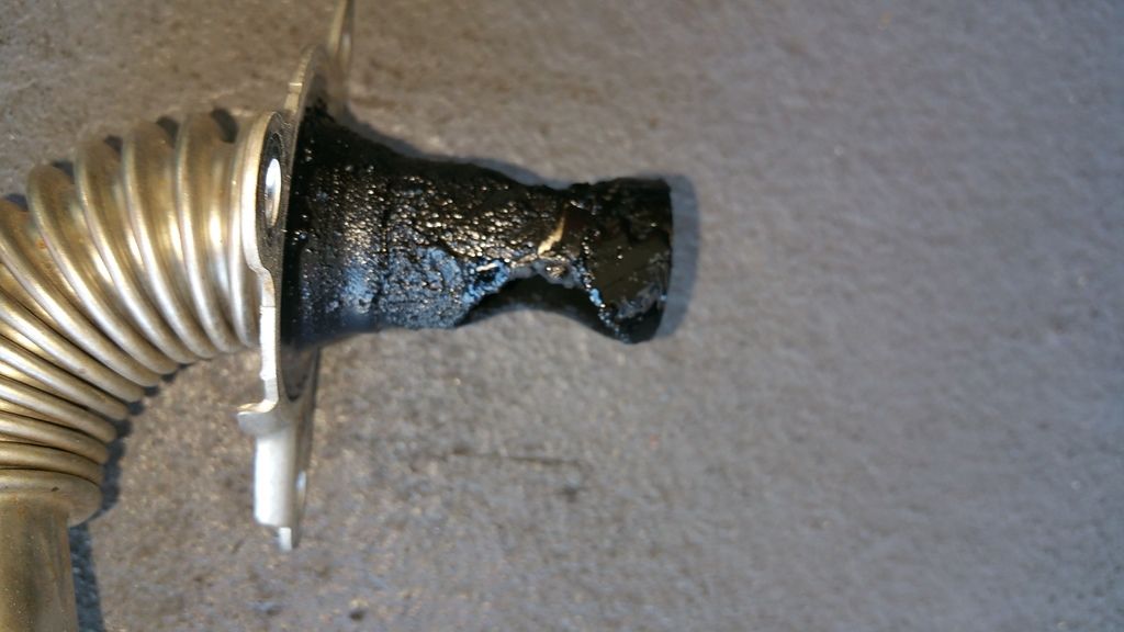

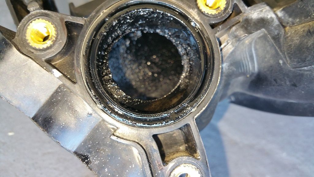

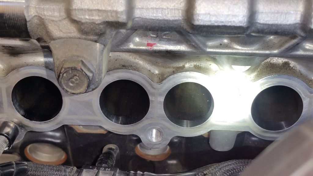

Well the deed has been done! I removed the intake manifold yesterday to see what gunk had been deposited by the EGR system. Not real good results. There was a good thick layer all the way down the intake runners and on into the intake ports on the head. The four little butterfly valves on the intake manifold had a fairly think coating of material on both sides, probably around 15%, at a guess, of the air flow to the engine would've been blocked by this material. Taking off the intake manifold wasn't too big an issue, just undo the series of bolts holding it on, plus the high pressure fuel line from the pump to the rail, plus the butterfly valve control , plus a few other sensors and such attached to the bottom side of the manifold. I also removed the airbox and intake pipe to the turbo to access the EGR system. Cleaning out the intake manifold was a pain. I used a pressure cleaner and about a litre of degreaser and a heap of rags to clean the head itself.
The whole intake manifold needed soaking in degreaser before I could remove all the material, it was a good couple of hours work, but came up a treat after I'd finished. I installed the EGR blocking plate in the far end of the EGR system and hope this helps keep the soot and such from entering the manifold in the future, at least to a pretty big degree. The car feels quicker now, especially around the 2000  to 2500rpm area, where there's a difference in the way the car pulls, I would say that there's maybe 10% more power available now, but some of this may be a bit of a placebo effect. Here's a heap of photo's for your viewing pleasure -
The intake manifold showing the amount of material on the butterfly valves
The intake ports on the head, again you can see the material deposited down the port.
The point where the egr system attaches to the intake manifold (the concertina type metal pipe)
The end of the egr hose
The intake manifold looking in from the end (same image from my first post). The second image is the same thing after cleaning
The head after cleaning, you can now see the metal down the intake port
The now clean intake manifold, the butterfly valves are actually yellow, wouldn't have guessed from the first photo.
This is the egr blockoff plate in place (actually on the front side of the valve, I installed it on the other end of the system to hinder the material from getting to the valve itself). You can see the hole that allows some material to pass so a code isn't thrown.
So what's the conclusion I've come to? I would suggest that cleaning out this system is a must do for any higher mileage i30, it definitely builds up to such a degree that the performance of the car is affected to a degree. Doing this work isn't the easiest thing in the world, but it's more than doable with a few basic hand tools.  I'm not sure what a mechanic would charge to do this, maybe a few hundred dollars, it's about 3 to 4 hours work, maybe a bit less if they'd done it before and had a parts washer capable of cleaning the manifold more easily than my technique with the pressure cleaner. Post up if you have any questions. Cheers

Taking into consideration your car have done almost 50.000 km/year it must have been driven very lightfooted, I guess. I sure don't hope the internals of my engine look like that.  :eek:
I keep telling myself the occasional towing with higher revs than normal, and a little spirited driving now and then, will keep my engine clean...
The average vehicle does about 15 to 20,000Km per year. I wonder if your 190,000km is attributed to a lot of highway travel or daily commercial use in a city?
As discussed before, if it is from your region, it is unlikely that A/C would be used all the time, therefore switching the EGR off.

I guess the question of the cars history is the elephant in the room, and it's a question I can't shed a lot of light on. I was told by the previous owner that the car was used predominantly to commute between the Southern Highlands of NSW to Wetherill Park in Western Sydney. This drive would be 95% highway kilometres st speeds above, or at, 110km/h. The problem is that I'm not sure if this is a good thing, as far as the function of the EGR system goes, or not. I'd imagine the A/C would have been used to some degree, going on the darkness of the tint on the windows (95% on the front two side windows before I had it changed to 35%) the previous owner liked to keep cool. So going on pure speculation I'd say the A/C would've got a bit of use in Western Sydney in Summer.... let's say 40% of the time in total hours driven (massive guess here).
So, 190,000km of mainly HWY kilometres with 40% A/C use, every service carried out, car very well cared for over that time (most people think it's a new car). This might be either the best conditions to avoid this build up, or the worst, hard to say. It's a pretty easy check to see what your intake manifold looks like inside, just take off the rubber hose on the right hand side of the manifold (use blunt nosed pliers to undo the strange wormclamp) and have a look.
I'm trying to assess the difference cleaning it out has made to my car, power wise, difficult to tell but this may give you an idea. Mt Ousley, the long climb out of the Illawarra going towards Sydney, is a road I drive regularly. Last week, before I cleaned out the EGR system, my partner and I drove up it, in 6th at around 80km/h (maybe 90). The car struggled on some of the steeper sections, although not enough to change down to 5th. Today we did the same thing, but with my two sons in the back, probably around another 90 to 100kg of weight on board, and two suitcases in the boot (having a weekend in Sydney). Again in 6th, but this time the car didn't struggle in the least, flew up and was able to maintain it's revs all the way from bottom to top. I guess that's the difference between a completely clean intake manifold and a egr blockoff plate and a gunged up intake manifold and open egr system, not a massive difference, but a difference all the same.

Assumptions stated and qualified, comparison made logically. Good science, and an important enough difference to be noticed. :victory:

How did you clean the intake on the head..?
I mean, all the crap you have removed, how did you get it out..? I wouldn't like to get all that into the cylinders and blown out into the cat/DPF when starting the engine again.

The port on the head is actually quite shallow, you can see the valve stem about 8 to 10cm from the mouth of the port. I just placed a rag over my finger and cleaned out each port, could almost get the whole way to the valve this way.
