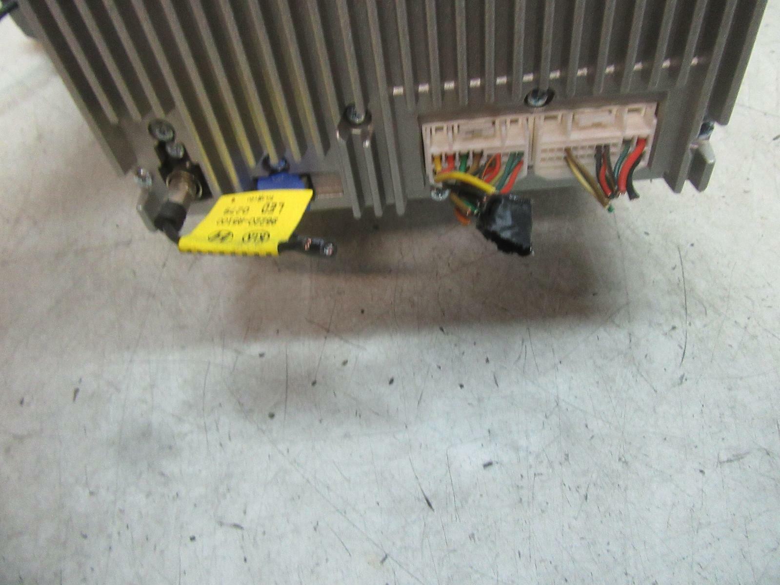

I can’t find anything under ‘CarPlay’ in settings. The vehicle doesn’t come up 😩
And Siri is definitely enabled. If I clock on the ‘voice’ button on the head unit it will activate Siri and lets me request things and answers all through the car.
But I’m still unable to select ‘apple CarPlay’ on the head unit. I’ll attach a photo. The option is there but it’s not lit up.

And no it’s Not the original cable from the donor vehicle. The guys at the wreckers used a pair of side cutters to take the head unit & AUX/USB jack assembly out. So the chord was cut in 2. I got one end but they said they couldn’t get the other 😩 so I made a chord using an old computer fan cable. The pin sequence is all correct and I know I’ve got all the wiring correct. Yet still no luck.
Might cut my loss and just use the head unit for Bluetooth audio & radio! At least I can still charge my phone on the USB.

Reported symptoms all pointed to a lead/cable fault, you can purchase the lead via Hyundai or Koraps or via a link posted previously in this topic that aanastasiou4 placed  https://www.fourgreen.com/store/mobile/prodView.asp?idProduct=6145963#mobileMain
Well worth getting the correct cable for such a handy feature, don't think I could go back to a car without AA/CP now that I'm used to it :)

Did you miss the part where the interconnecting cable used was home made :whistler: :D

I would be very surprised if it's the cable. There's nothing special about it, I measured it when I repaired mine and it's simply 4 x 2 feet of copper.
Did you follow the full instructions while upgrading? There are several parts to it, and afterwards you are supposed to do a full settings reset. Did you do all of these?
  • i30cw 2013 1.6 auto
You can get away with repaired cables on Android Auto but Apple CarPlay is extremely fussy when it comes to cables.
If the chip doesn’t receive the correct voltage or sync data then the phone will charge but will be unable to recognise CarPlay.

I soldered together the two ends of the cable. It was cut by ultimatejap's dismantlers.
4 wires and a shield. Nothing to it. We're not talking about GHz signals through these cables. If we were, I'd have used the spectrum analyzer to to a DTF analysis.
It took me 10 minutes, 7 of which was making spent on a cup of coffee.
