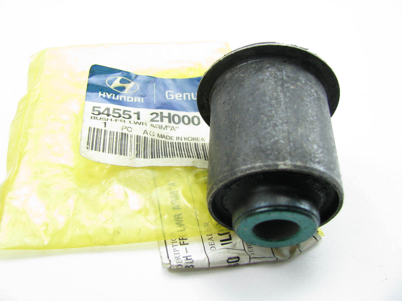

If it's failed then the geometry would be out
545512H000
BUSH - FRONT LOWER ARM "A"
545842H000
BUSH - LOWER ARM
545002H000
ARM COMPLETE - FRONT LOWER, LH
545012H000
ARM COMPLETE - FRONT LOWER, RH
