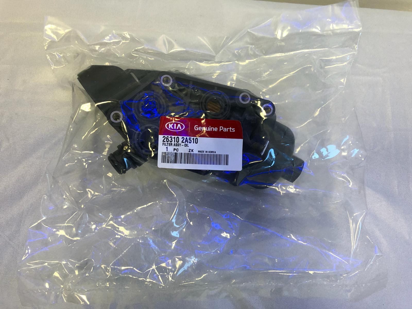

No experience with the cooler, could it be simply the gasket or the could be O-rings
Cooler to filter body
1 x 263132A500 (26313-2A500) - O-RING CENTER PIPE
2 x 263142A500 (26314-2A500) - SEAL-OIL
Filter body to block
1 x 263112A510 (26311-2A510) - GASKET-OIL FILTER
entire filter assembly
If you get that,should include all items in that window, seals gaskets filter element, then cooler is separate item to bolt on
263102A510 (26310-2A510) - FILTER ASSY-OIL
:link: Genuine Kia Sportage/Rio/Ceed/ Oil filter assy 263102A510
264102A300
:link: KIA SPORTAGE 1 SL 2010-2014 2WD 1.7 CRDI OIL COOLER 264102A300 | eBay
:link: Oil Filter Housing Hyundai ix35 Tucson TLE 1,7 CRDi D4FD 26410-2A300 EN236563 | eBay
It's a manual
excludes possibilty of trans fluid then.
also wonder since filter body is plastic is a crack in that could lead to oil entering the water piping
Price wise you'll just have to use those part numbers and work it out.
That filter body assembly might be good value regardless in the long run

What's interesting is you guys get a plastic body, ours is alloy, wonder why? Tolerances in extreme cold?
If we assume it's in this area that the contamination is occurring if I had to guess which part my gut tells me the plastic body is more likely to deteriorate and hairline fracture than the cooling element.

Cooler has 2 water ports.
Therefore @chrisnka  cannot be sure which unit is leaking. The plastic will probably be more expensive new. Best to go to a wrecker and get the whole unit with cooler attached.
I've highlighted the water points on the filter body
It's  cheaper than the cooler element if that unit I linked on Ebay is purchased
A used one is a worthy option, also linked a very cheap one 15GBP plus the same assembly is used on a multitude of models including the 1.7L CRDi
