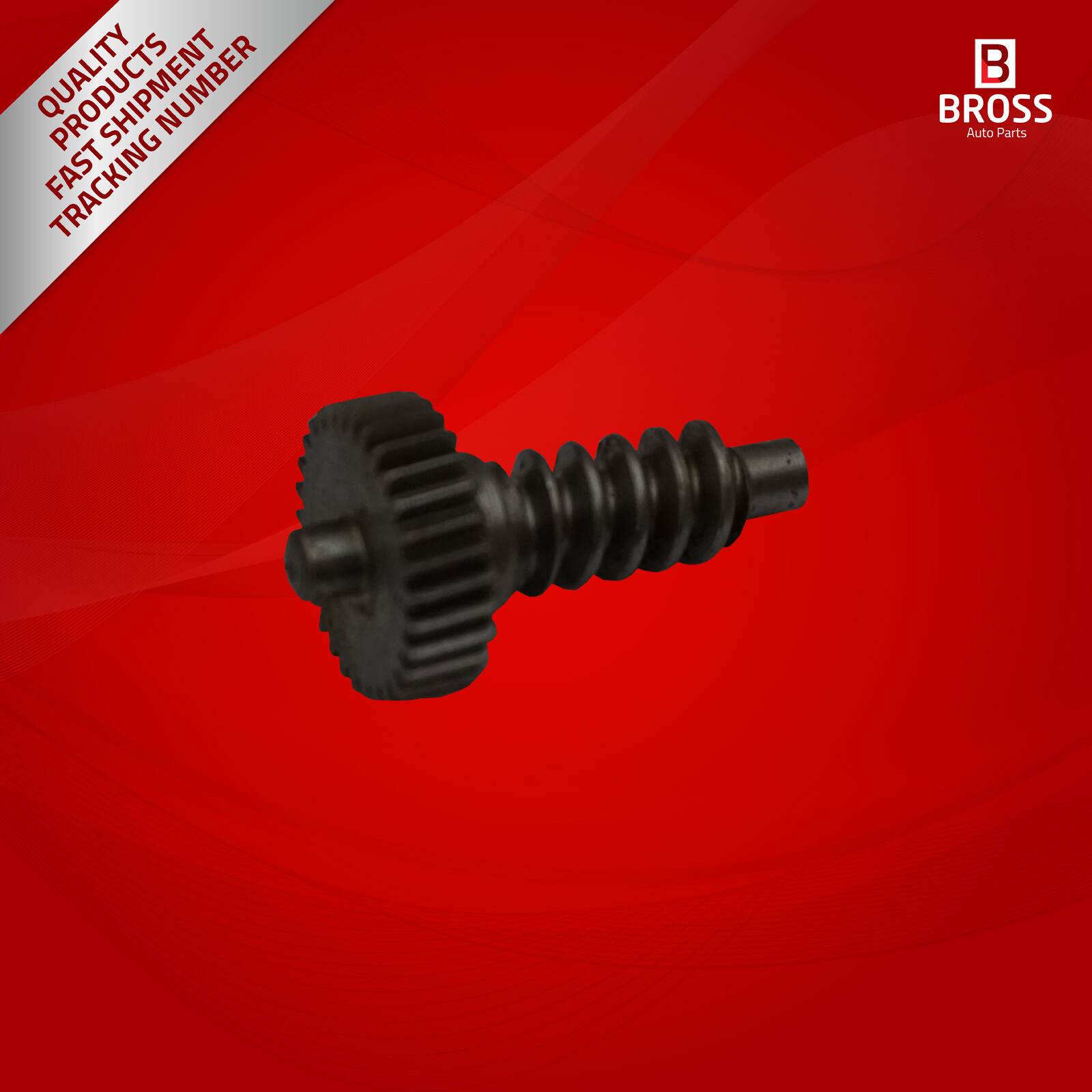

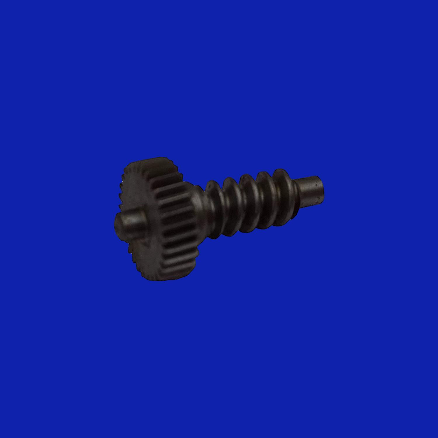

Yeah, the plastic gear inside retracting motor has cracked. Popping the plastic trim inside at the mounting point and removing harness will stop it, but it also kills everything else including the blinker.
I'd refrain from cutting a wire unless you don't give a shit. You could pop the mirror out and then I think it's a pair of wires green and red with a rubber seal. Behind the seal is teh 2 pin plug, pull that out and that  kills the motor. You may want to plug the gap and tap the connector to keep moisture out.
You could try and find a smashed one cheap at the wreck and  swap the gear or motor over. The gear is thye same in FD, GD and i40 electric folding mirriors.
Someone has also developed a one piece plastic gear on Ebay (Bross) not cheap but cheaper than a mirror.
