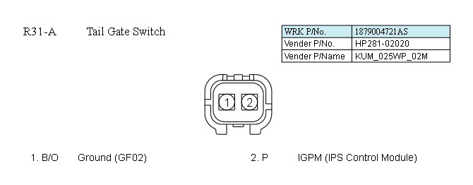

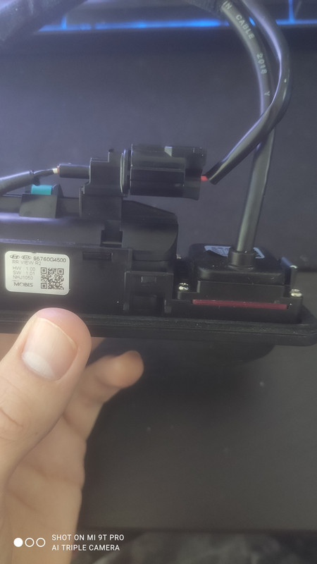

Hi, I have an 8 "radio from the I30N version. I'm trying to connect the camera, also from "N". The camera has 8 pins. I am looking for a schematic or maybe someone knows how to connect.
I got my camera from a normal non N i30, so I don't think it's N specific for this camera. And looking at owner manual, the integrated camera in tail gate handle seems to be the standard for the Wagon, like I have.
The 6-pin camera seems to be standalone for the camera only while the 8-pin is integrated with the tailgate handle, so the extra 2 cables are most likely for the tailgate mechanism.
Looking at the schematic for the 8pin, 2 pins on the 8-pin are empty from camera side.
SAD UPDATE
So I tore off the tailgate trims and lo and behold, no spare 6 or 8 pin connector to connect the camera to, even though schematics says that I should have. So if I want to connect my camera, I have to pull new wires, and then it's a much bigger project all of a sudden :(
