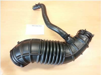

I searched the internet and I found that the korean (or U version before 2009-2010 revision) version has a big pcv valve situated on the small hose that comes from the rocker cover to the air intake hose (between maf sensor and turbocharger).
Here is a picture with that version.
Mine is made in Europe (czech version) and does not have that lump on the hose (the pcv valve).
Here is a picture with my version.
The schemes say the same thing. On the ''old'' U engine there is clearly a PCV valve but on the U2 engine it dissapears and I can't find any info on that.
Does my car have a PCV valve? If it does where can I find it?

Its same place, just in a metal tube ( classic design).
A bit of oil in intercooler is common as turbo seals age. A lot of oil is problematic.
The most common cause of oil in intake manifold is from EGR. Do normal maintenance cleaning.
PCV valve is easy to test. Usually not a problem.

CAn't find it and not sure if it is a PCV. have you inspected yours? Is it a straight through pipe? have a look.
If it is a PCV then I say you need the entire intake hose
281301M250
Tw2005 - please help me with the PCV valve part location and part number.
281301M250
If open tube, They seem to be using the PCV that our 2.0l petrol motors have. Its screwed into the cam cover at other end of that small hose. Unscrew it and use mouth to suck and blow. If it blocks in one direction its ok.
