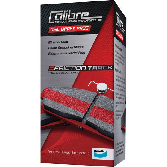

I've found a "pair " of front rotors, AC delco $70, allow $100 with freight or it's a cut lunch from your place
Bendix fornt pads, DB1754
Repco has their set on sale $62
Supercheap have there cheap range by bendix @ $62
Likely at a $100 it's Bendix general CT
Of course getting all your own parts I'd expect teh labour reat to go up but It hink you could work out in front still and I expect a lot of this could be overkill
