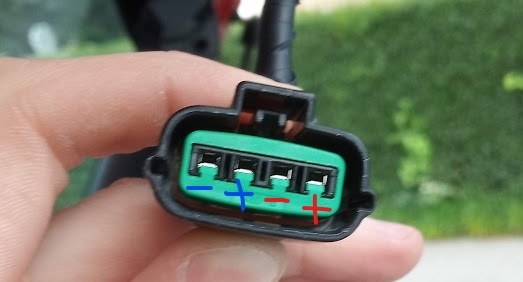

EDIT:
Weather was on my side so I managed to check with a multimeter. I'd say the second thought I mentioned was correct.
I unplugged the connector from the lock.
This is always 12V.
This is 0V. Only when I press the button on the door, it jumps to 12V then drops to 0V no matter how long I have it pressed.
I'd say the lock itself is faulty.
