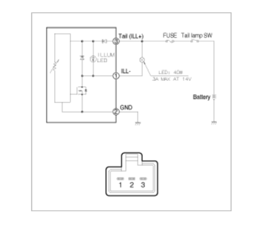

As you can see there are components in the dimmer such as the diode that may be faulty.
The dash light LED is between pins 1 & 2, rheostat takes 2 to 3(earth) for full brightness.
Disconnect these and measure for short at dimmer or in cluster.
If cluster has short or is open, it would be repairable.
