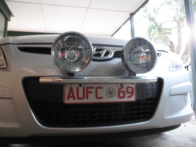

I'm thinking of fitting a couple of spotties to my CW diesel as I do a bit of country road driving at night. I know there are air bag sensors in the front of the vehicle and was wondering if fitting the lights and mounting bracket would impact on either vehicle safety or warranty.
I've attached a pic of the sort of thing I'm looking at, but with smaller rectangular lights. The bracket fits where the front number plate mounts.
Any thoughts from the knowledgeable folk in the forum?

nah wont affect anything... its wayyyyyy too flimsy
you would only have dramas if you fitted a steel roo bar...

Thanks for the feedback. I spoke to my local Hyundai dealer regarding the spotlight bracket interfering with the air bag sensors. No problems apparently. The air bag sensors are nowhere near the front bumper.
  • Lubricious, the greatest 2010 CW Auto diesel.
UM, when you've got thel ights fitted, if there is some evidence of vibration in the spread of light from the spots, you may need to brace the top of them. You used to be able to get these from performance shops so I guess they'd still be around.
All depends on how firmly the bar is mounted and how heavy the lights are.

here is a pic of the bad boys that surferdude is talking about!!! if you look at the IPF range of lights there is a little rubber grommet in the top of them, it is for these!!!
