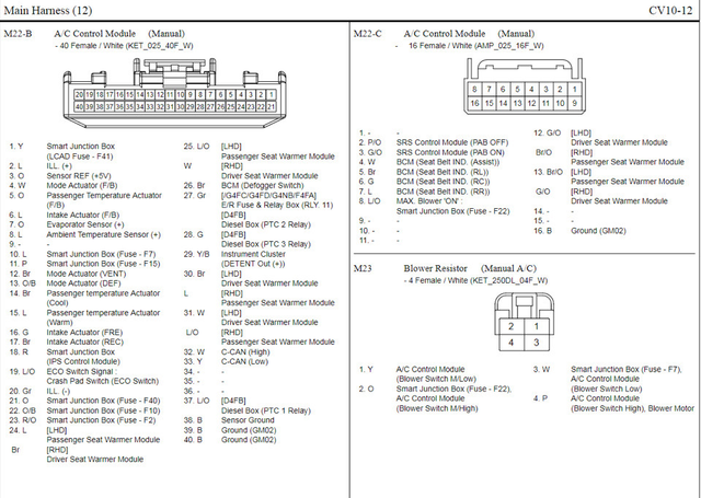

I was doing some research and I noticed a lot of people were sharing pictures like this one:
I tried to find the source file for that, but I couldn't and I'm wondering where people did get it?
The best I could do was finding it in Russian for the 2012 GD. I want to check the pinout for the 14 pin clock spring (93490-A6315) connector (that comes out of the "car" and connects to the bottom of CS) in this pdf, but I couldn't find it, so I'm assuming I need a newer edition(?), preferably in English. I heard about alldata and autodata, but I can't register in any of those as I don't have a shop and I'm not even sure if I'd find anything there.

Haynes, I have wiring diagrams for most things on there.
