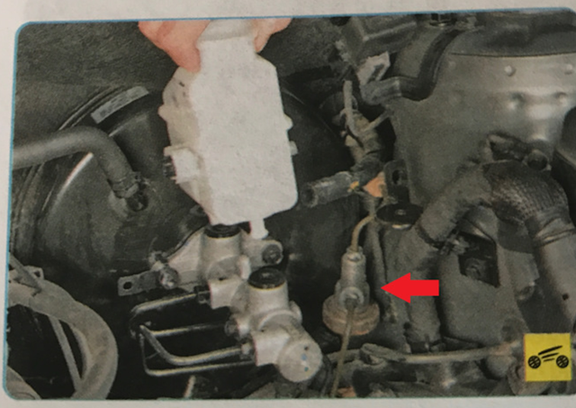

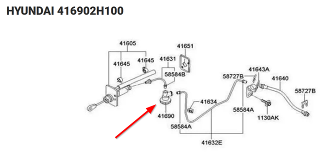

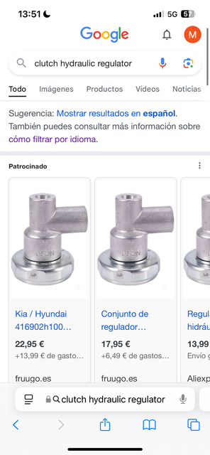

Someone could tellme where is this part in this car I have to make an adjustment and I can’t find it
Is the clutch hidraulic regulator
I have an Hyundai i30 Mk2 1.6 CRDI 2013

Get yourself a M16x1.5 plug and throw that stupid failure prone regulator to garbage bin. It's really not needed and you get better / faster shifting without it. Most likely your plastic master cylinder is on its way also (and actuator pin hole oval) so do yourself a favour and change that as well once you're there: Sachs 6284600872
