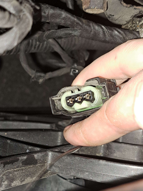

  • After driving and letting the car idle, I noticed the radiator fan never turns on
  • Even when the A/C is switched on, the fan does not activate

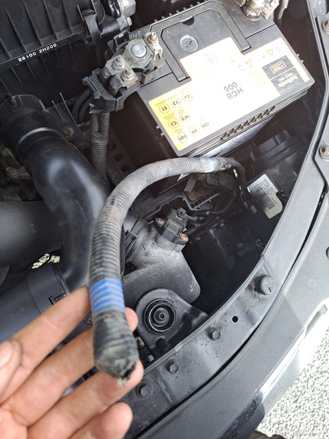

  • I found a loose 3-pin female connector near the fan area and another taped-up wire near the battery and headlight area
  • I traced the fan wiring and suspect that the fan motor or control module is not connected properly
  • It's possible the fan has been disconnected or cut in a previous repair attempt
